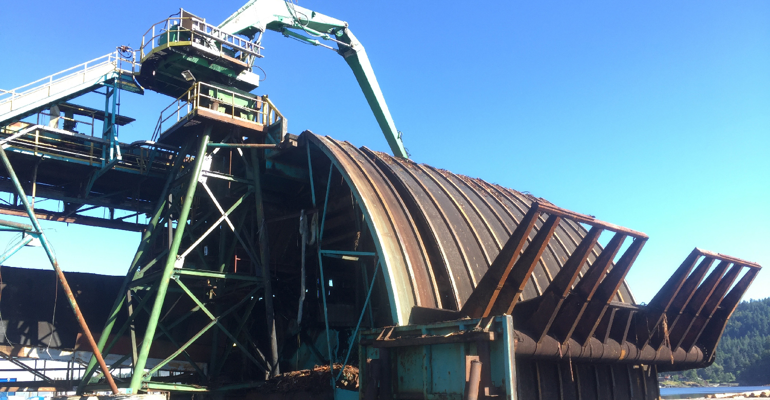

Hydraulics is great for lifting heavy loads and applying large amounts of force, but the same power that is required to exert a large amount of lifting or compression force can also do damage or produce waste if not controlled. A sawmill in British Columbia used a pair of 31-ft.-long hydraulic cylinders to operate a carriage that lifts log bundles into the mill (Fig. 1), but the lifting carriage occasionally sustained damage by the hydraulic cylinders moving at different rates of speed.
1. The arms that lift bundles of logs out of the bay and into the sawmill is operated by two 31-in.-long hydraulic cylinders.

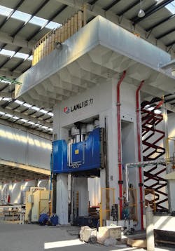

In China, a 3,000-ton automotive body panel press (Fig. 2) failed to reliably keep the platen level during a compression cycle. In Indiana, a vehicle roof-crush test system (Fig. 3) needed to exert a precisely executed and documented amount of force up to 100 tons on a vehicle roof as large as that of a school bus in order to meet industry safety specifications.
2. The platen in the automotive panel press must remain level even as up to 3,000 tons of force are being applied.
