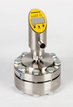

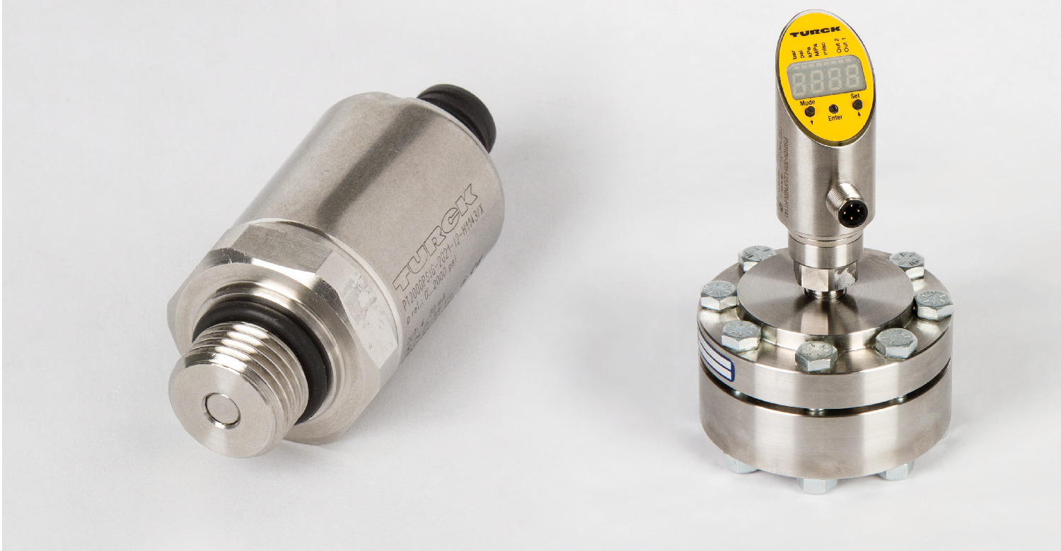

Application challenge #1: The media being measured clogs the sensor.
In extreme applications, accessories such as a diaphragm seal can be added to isolate the sensor from the media being measured. When choosing a diaphragm seal, look for designs with large open areas that will resist clogging, and a cleanout port to facilitate the removal of material buildup.
While pressure measurement is a fairly straightforward concept, the media which is being measured can vary in numerous ways. In most instances, the media is as ideal as clean air or water, but there are applications where media can have debris mixed in, such as contaminated coolant or slurries. If not managed properly, the media can clog the measuring cell on the pressure sensor, causing the sensor to improperly measure the force being applied. This often results in damage to system components.
The ideal solution is either to filter the media before it reaches the sensor or isolate the media from the sensor. In many cases, filtering the media is not possible or practical, but engineers can solve this problem through sensor product selection.
In extreme applications, accessories such as a diaphragm seal can be added. Diaphragm seals are liquid-filled devices that isolate the sensor from the media being measured. Look for designs with large open areas that will resist clogging. Another feature to look for is a cleanout port, which allows a separate connection specifically designed to facilitate removing material buildup.
In some applications, using a diaphragm seal is not an option. In these cases, select a sensor that allows unobstructed access to the measuring cell. This design will not eliminate clogs, but can minimize the likelihood of clogs that cause unwanted system downtime.

Application challenge #3: Dynamic pressure and pressure transients may occur.
Many of today’s pressure sensors offer an integrated snubber that can reduce the effect of pressure spikes and reduce potential leak points. Sensors with snubbers built in, like the one shown, offer an advantage because the snubber cannot accidentally be removed during sensor maintenance or replacement.
Pressure transients, sometimes referred to as water hammers or pressure spikes, are common in liquid media. A number of factors can cause these transient spikes, such as the sudden opening or closing of valves, pumps turning on or off, or an object suddenly disrupting the flow of the media. This sudden shock to the system often results in a pressure spike that is many times higher than the normal system pressure. The spike in pressure has the potential to damage system components.
One of the best ways to avoid pressure spikes is to eliminate them before they become a problem. A common solution is using soft start systems for pump control. Instead of the instantaneous flow of media, the soft start allows a gradual flow to occur, thereby minimizing the potential for a pressure spike. Unfortunately, not all applications can use this approach.
When a soft start system isn’t possible, the easiest solution is to add a pressure snubber. This is an accessory installed between the process media and the sensor that is designed to dissipate the pressure spike.
While there are different methods of pressure-snubber construction, the concept is to help take the high-pressure spike and distribute it more evenly, thereby lowering pressures to the measuring cell. Many of today’s pressure sensors offer an integrated snubber that can reduce the effect of pressure spikes. A sensor with an included snubber is an advantage because the snubber cannot accidentally be removed during sensor maintenance or replacement. The design also reduces potential leak points as it is an internal component of the sensor.
