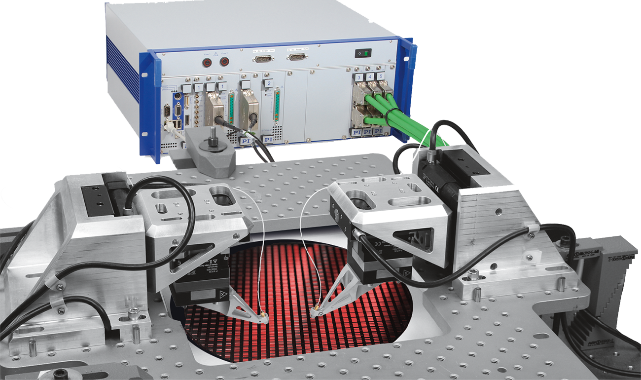

This equipment is a typical test and alignment system from Silicon Photonics wafers based on closed-loop, motorized, XYZ micro-positioning stages and piezo nanopositioning stages.
A nanopositioning device is a mechanism capable of repeatedly delivering motion in increments as small as one nanometer. Industry standards have pushed that requirement to as small as 1/10th of a nanometer and below. There are different methods to achieve nanometer precision motion. The best positioning systems eliminate friction—their drive system and guiding system are frictionless and not limited in resolution. Frictionless bearings also avoid the contacts caused by typical bearing balls and rollers, providing vibration-free motion with a high constant velocity.
Engineers who design these bearings for the guided moving parts work within tolerances of a few micrometers. However, a nanopositioning device requires precision movements that are up to 1000 times greater. Such precise movement is achieved with piezoelectric crystals; they can expand and contract slightly via voltage simulation, and are usually paired with an active feedback sensor for fine-tuned control. The crystal is mounted onto the moving part of a linear actuator capable of large displacements with a single stroke. This configuration is known as a serially actuated dual-stage design.
