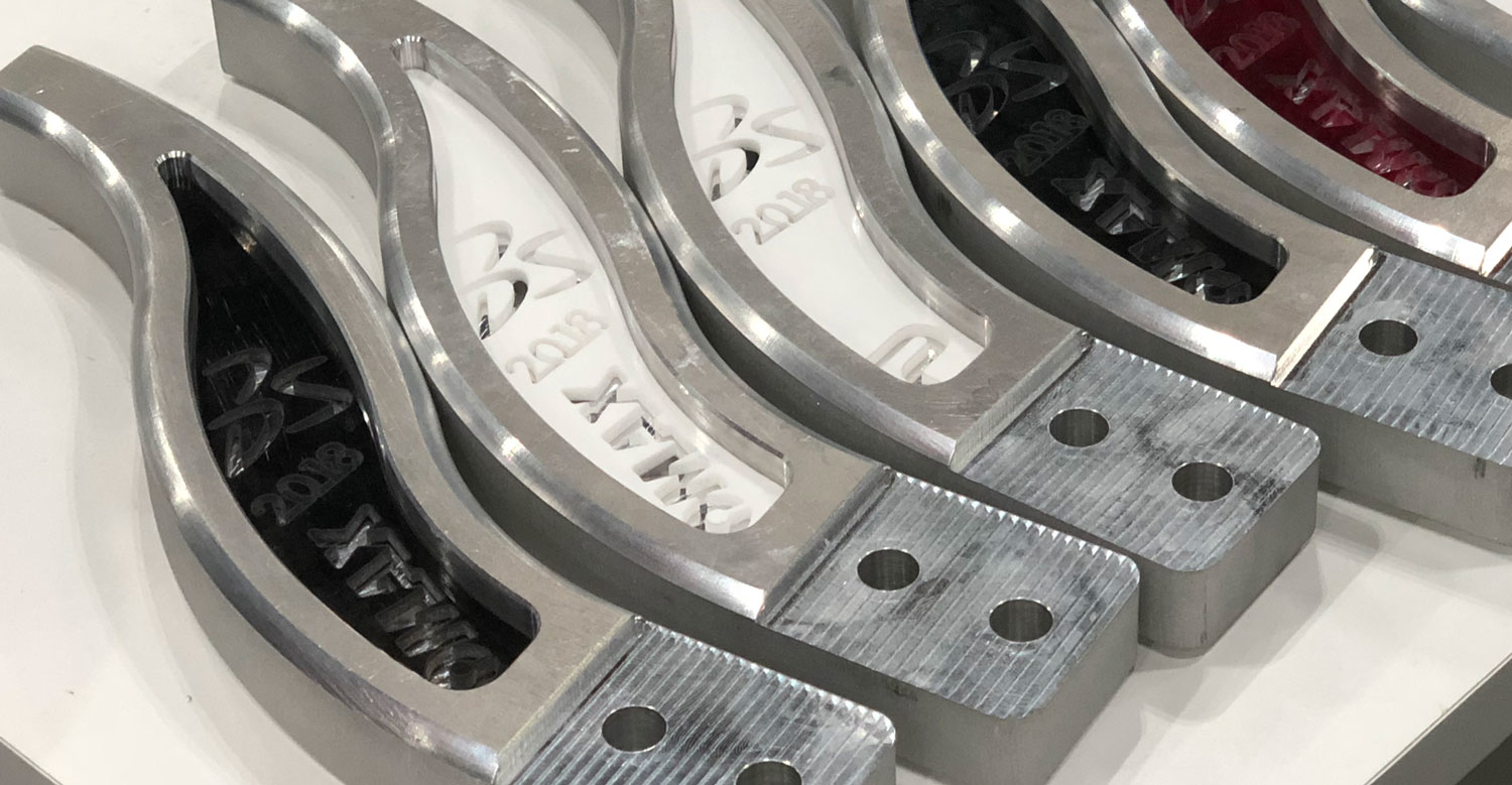

At Solidworks World 2018, the power of design and fabrication is a cornerstone to the company’s motto. With every new update, it brings new tools to machinists and manufacturers to ensure they have accurate production parts. In one of its product showcases, Solidworks setup a mini machine shop creating from start to finish shifter arms for a vehicle. The showcase highlights how a designer can use Solidworks CAM to take their part from the mill all the way to inspection and engraving.

The first step prior to milling is to cut out the 2D profile. The OMAX protoMAX waterjet cutter is responsible for cutting out the profile on the arm component of the shifter arm assembly. The cutting process starts with a flat plate of material. Once the part is programmed, the protoMAX cuts the profile out of the blank metal stock. After the process is completed, the part is sent to the mill to remove the piece from the blank.
Zone #2: 3+2 Milling
The Haas UMC 750 is responsible for milling the arm component of the shifter arm assembly. The process starts by milling from the 2D profile completed in Zone #1. The part is programmed into the UMC 750 and creates the necessary steps to mill out the arm. The mill uses water to make the machining process easy and smooth. Once the milling is done, the part is ready for quality inspection.
