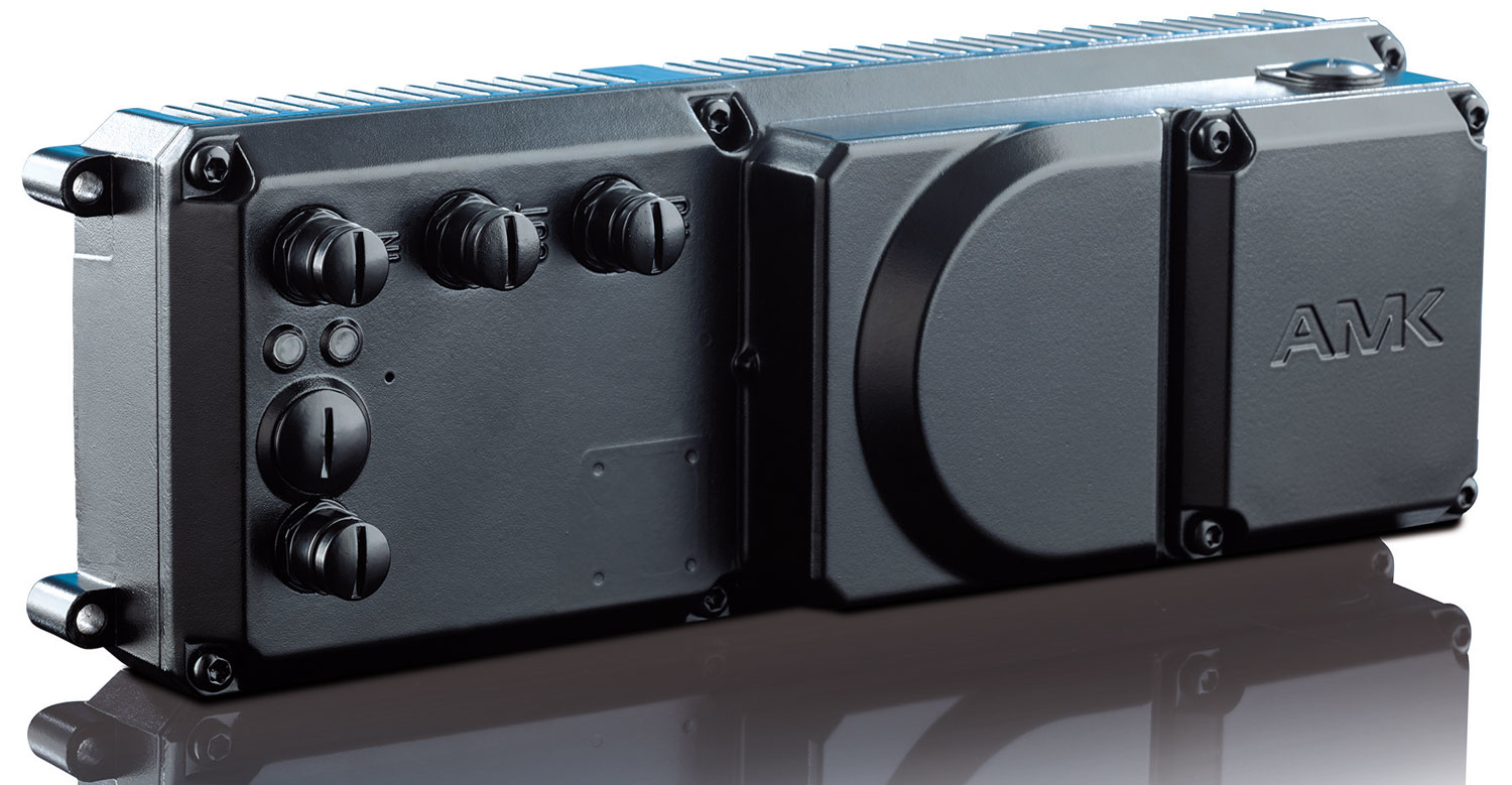

This decentralized motion controller performs the complete control of a machine segment and can be used as a gateway to higher-level controllers. For automation completely free of control cabinets, an integrated incoming supply generates the dc voltage for connected servo axes.

Certain cabinet-free technology portfolios now include the final piece of the puzzle: motion controllers (or PLCs). They integrate all of the controller hardware needed into modules that can be mounted on the machine, along with the drives and power supplies—in essence, eliminating the need for a control cabinet completely.
One manufacturer offers a unit that combines motion control, communications to higher-level machine networks, dc bus power, and an integrated 24-V supply and control intelligence, all housed in a modular package that is IP65 rated and maintains multiple high-speed digital control interfaces such as Profibus, Ethernet I/P, and EtherCAT. Combined with multiple decentralized power-supply and inverter modules, this one controller can support multiple 10-A servo motors, including both servo motors with drives integrated into the motor housing as well as configurations that separate the drive and motor.
This platform supports full-scale motion-control functionality, including high-accuracy synchronization of multi-axes systems, cross-communication in real time across several levels synchronized with high accuracy, and motion-control functions such as:
  • Virtual master axis
  • Electronic cam
  • Print mark control
  • NC motion
Until recently, truly cabinet-free designs were considered risky and experimental, in part because PLC functionality was not widely available for installation outside the cabinet. With the availability of these types of controllers, the full potential advantages of cabinet-free systems can be explored.
