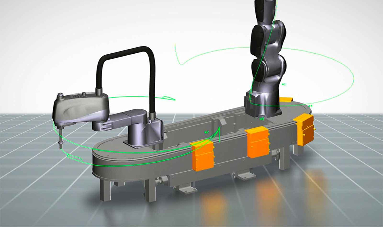

B&R Industrial Automation’s SuperTrak Simulation
Putting its SuperTrak technology front and center, B&R will highlight a new visualization tool that accelerates development of automation solutions. The SuperTrak, introduced in 2017, is an industrial transport system that uses magnet technology to guide individually controllable shuttles along a track using long stator linear motors. The new simulation tool provides users with a 3D simulation of all SuperTrak shuttle movements, including its synchronized subsystems such as robotics and CNC.
The new visualization tool aids machine builders and operators, helping accelerate the commissioning process by validating their designs and sequential programming prior to build. The tool and extensive simulation options can be found in B&R's updated Automation Studio software development environment. All simulations are based on real machine code and require no additional simulation software or interfaces.
To find out how SuperTrak and its visualization software can aid your motion process, visit B&R’s booth 4229.
