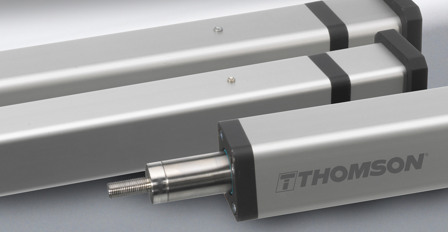

Thomson PC Series electric actuators are designed to deliver superior performance while saving time and money thanks to easy product sizing and selection, quick and reliable installation, and reduced maintenance.
