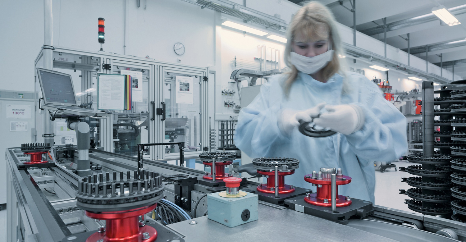

Specialized PVD Coatings
A PVD coating such as BALINIT C is particularly suitable for case-hardening as well as ball- and roller-bearing steels because it can be applied at temperatures under 200°C.  Due to its low friction coefficient, the coating acts to reduce pitting and fretting corrosion.
Physical vapor deposition describes a variety of vacuum deposition methods that can be used to produce thin coatings. PVD is typically used to coat components at relatively low coating temperatures of 200-500 °C. These temperatures are ideal because they are below the tempering temperature of steels to avoid altering the fundamental material properties.
Modern coating techniques for PVD include specialty carbon-based coatings from Oerlikon Balzers that provide a unique combination of extreme surface hardness, low friction coefficient, and anti-corrosion properties. There are also coating techniques that are metal-free, carbon-based coatings that are even more durable. Applied through Plasma-Assisted Chemical Vapor Deposition (PACVD), this coating is designed for more severe wear conditions and high relative sliding speeds to protect against abrasion, scuffing and cold welding. These and other coatings are tailored to specific requirements can be applied to a variety of case-hardened or tempered steels, austenitic stainless steel as well as nickel, titanium, copper, magnesium and aluminum alloys. The coatings also have the advantage of being thin, typically 0.5-4 μm. This feature, in conjunction with close tolerances, means that the component retains its form, fit and dimensions after coating without the need for re-machining.
