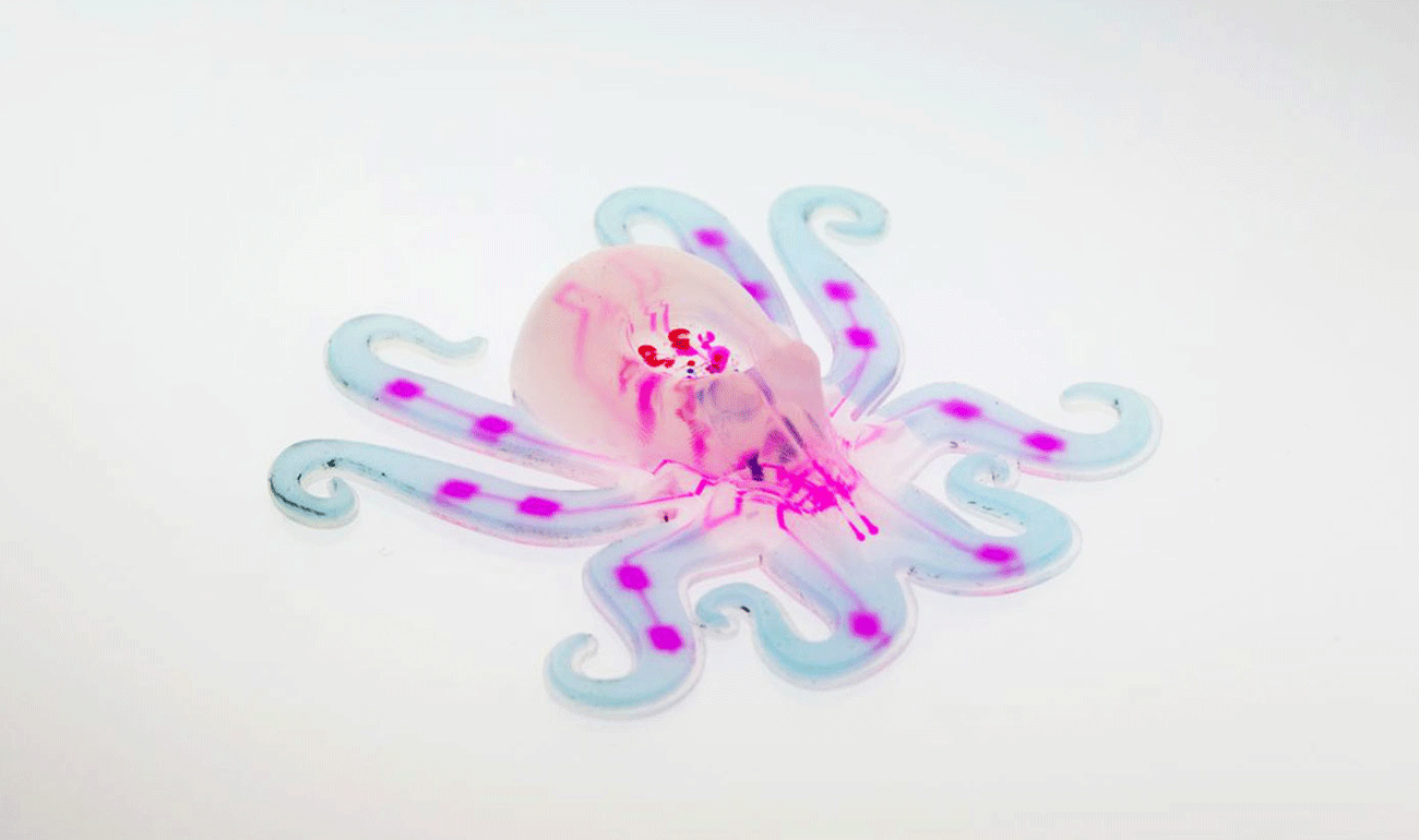

The Octobot, an example of soft material robots, moves on its own by turning hydrogen peroxide into gas. (Courtesy of Engadget)

A prototype model of a soft octopus-like robot is manufactured in layers built up during a 3D-printing process. Integrated systems animate its movements. (Courtesy of Yigit Mengüç /American Scientist)
A practical test example is the soft octopus robot being developed by Mengüç and his colleagues. The octopus serves as a perfect example of what soft robots strive to emulate. The muscle makes for an ideal actuator and the tissue is an exquisite transducer, turning energy directly into mechanical motion and is self-assembling and self-healing.
The octopus robot is pressurized with fluid and controlled with valves made by inflating two micro-channels placed in contact with each other in order of the expansion, so that the first channel closes off the second. The time delay between pressurizing the first and shutting the second was used to make the octopus robot raise and lower its arms. Such soft robotics will create a new possibility for robots to be more flexible and powerful in the future.
