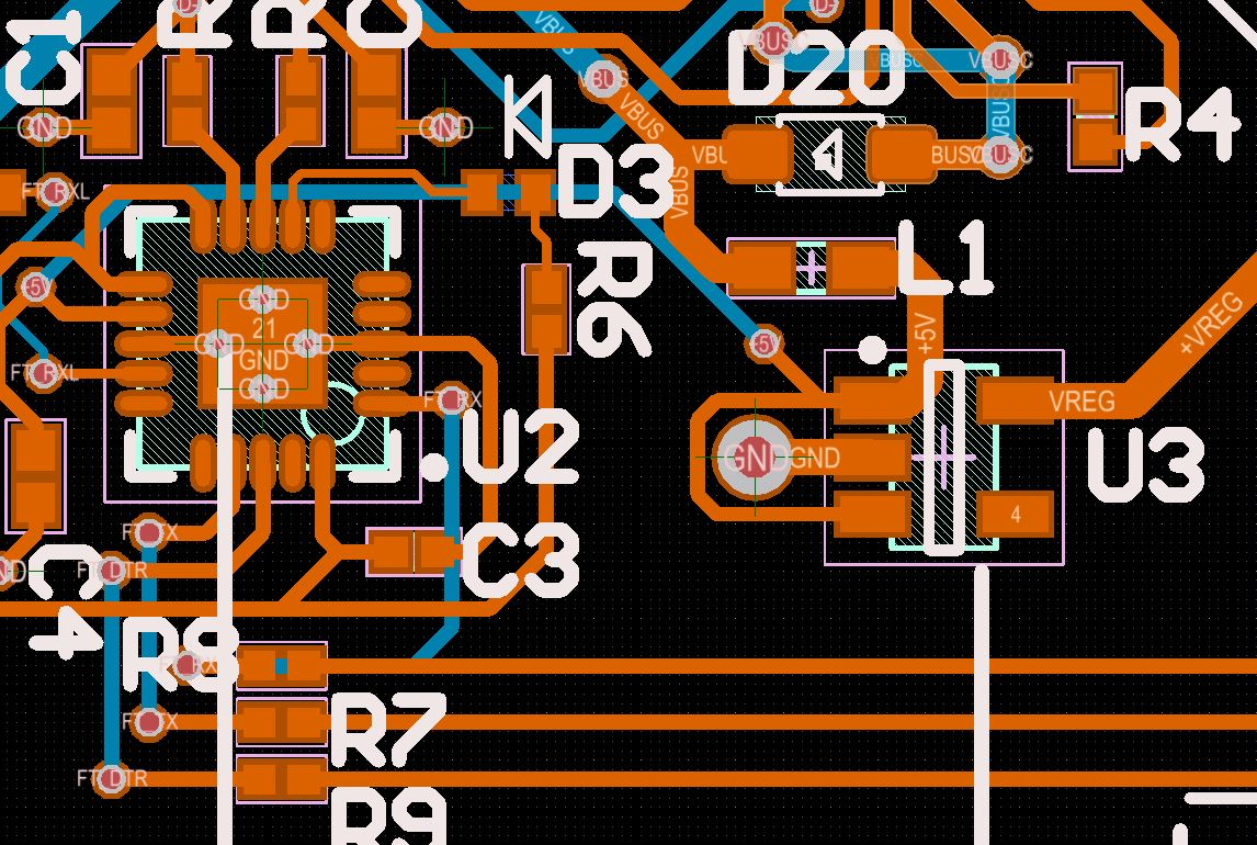

With PCB CAD, the first step is called “schematic design.” It involves taking schematic symbols —line-art versions of components that show the electrical workings and connections, but not the mechanical packaging—and drawing wires (called nets) between all of the various component connections to create a working circuit.
The next step, called “layout,” is just as important as schematic design, but often regarded as little more than an afterthought. The layout portion of PCB design again uses CAD software. In the layout phase, the PCB size is defined, all of the components are positioned based on their mechanical footprint, and those wires drawn in the schematic design phase are routed in what will become the physical copper traces on the finished circuit board.
This is an example of how to set design rules in PCB CAD software like Altium Circuitmaker.
However, it is not as easy as it sounds. Many of those copper traces need to do different jobs. Some carry a lot of current or voltage, while some carry low-current high-frequency signals. In mechanical design, fasteners are a decent analogy to the copper circuit traces, and come in a multitude of sizes and grades. In PCB design, copper is just copper, but it can be put down in different widths on the PCB, based on design rules.

  1. They set the limits of the capabilities of the PCB fabrication company you will use to make your blank PC boards. For example, if your fab house has a minimum trace and space (between traces) of 5,000th of an inch (5 mm), your design rules and a design-rule check will ensure that none of your traces or spaces are too small for their processes.
  2. They can be used for rules-based design. Some software will automatically size traces based on the design rules you set ahead of time. With this type of software, if you want all of your power and ground traces to be 16 mm, you set a net class with a width of 16 mm, and assign the power and ground nets to that net class. The software would automatically make any power and ground nets 16 mm wide.
Your design rules will be a crossover between what you need and what your fab house can produce. Some more primitive CAD software will require that you manually pick the width for a via or copper trace if you want it to differ from the default. Other software, as noted above, will let you set up a series of design rules, and will pick widths based on those rules.

For example, you might specify that power and ground traces are 16 mils in width and standard signal traces are 8 mm wide. The CAD system would then default to those widths when you picked a net in that net class. The net is the connection, like from pin seven of chip U2, to pin one of diode D3. The net class would be the type of net, like power or ground, or signal.
You will need to refer to your fab house, both to ensure that they can build what you need, and to get the final say on their design rules. Some fab houses, such as Sunstone Circuits, even have downloadable design rules for various CAD packages. That makes setting things up a lot easier.
