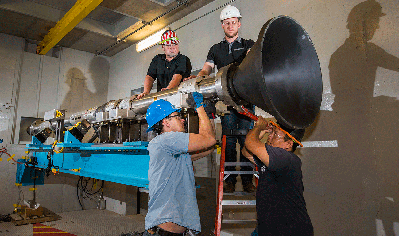

Engineers at the Sandia National Laboratories prepare a nitrogen-powered gas gun for the Alternative Pyroshock Test by installing a resonant cone to a resonant beam. The new testing method will create a more environmentally friendly way to ensure avionics can withstand the shock from stage separation during flight.
The APT uses the nitrogen-powered gas gun to shoot a 100-lb. steel projectile into a steel resonant beam. This transfers energy through a resonant cone attached to the part of the aircraft being tested, which mimics the conditions of stage separation in space. The first test of this type using the flight hardware was completed this past spring. Initial investigations into test alternatives led them to using a Hopkinson bar.

A 100-lb. solid-steel projectile, fired from a 6-in. gas gun, impacts the material of a resonant bar attached to a test article. The impact initiates a wave that travels through the resonant bar assembly into the test article, simulating a stage-separation pyroshock event.
The nitrogen gas gun used for the APT is 60 feet long and fires the metal projectiles into a resonant beam coupled with a resonant cone to expand the final diameter to interface with the rocket. This is Sandia’s large-scale hybrid version of the Hopkinson bar technique. The resonant beam is 1,500 lbs. and slightly over 8 feet long. The resonant bar and cone vibrate at the correct frequencies to apply the right amount of energy for testing.
