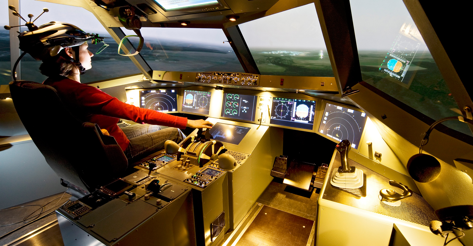

Another EU-funded virtual environment program to help pilot aircraft is the i-Vision project; it uses VR to evaluate the cockpit configuration. The i-Vision concept was inspired by Airbus’ wishes to explore flexible and low-cost tools for designing and evaluating future aircraft cockpits. The i-Vision project uses VR simulation to test new cockpit components and how crews would interact with them. By using a VR head display, a finger tracking system, and a flight simulator, the program can analyze a stream of data from the flight instruments and provide insight into the pilot’s behavior.
i-Vision uses virtual reality to test out new cockpit configurations and components to better design future aircraft.
The program also makes use of digital languages, also known as semantic web technologies, which have been specially developed to define and find connections in data that can be easily expressed for machine processing. This eliminates the need for the costly and time-consuming physical mockups for testing. These semantic engines help virtual reality frameworks to be more useful and relevant for collection human operator data, according to Dr. Dimitris Mavrikios of LMS-University of Patras in Greece, leader of the i-Vision project.
“This makes virtual cockpits and interaction with them smarter than simple simulators,” explained Mavrikios. “Virtual reality offers a unique and critical advantage when compared to the more conventional desktop simulation. [It has] the ability to obtain information directly from the user’s actions and behavior during the simulation of a scenario.”
The i-Vision project finished last year and soon will have an impact on how cockpits are developed. Airbus will be using the tool to test new experimental cockpits, taking into account human factors at the very start of the design process.
