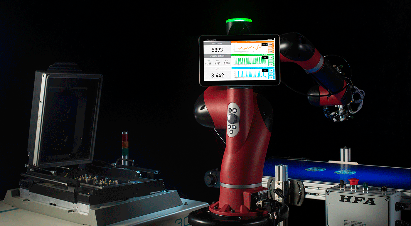

Earlier this month, Rethink Robotics announced the release of its robotic software, Intera 5.2. The new software platform provides critical data insights to manufacturers in real time. For instance, Rethink Robotics’ Sawyer gives operators and line managers valuable data at a glance, including metrics such as cycle time, part count, speed, and force.
This marks the first time that data collection is available from a collaborative robot. Called Intera Insights, it displays key performance indicators (KPIs) via a customizable dashboard on the robot’s on-board display, making it accessible directly on the factory floor. The same charts are also fed back to the Intera Studio platform for other members of the manufacturing team.
Sawyer, the popular collaborative robot from Rethink Robotics, now can operate in the Internet of Things with its new Intera Software. The software turns the robot into a data-collecting device.

Intera Insights can provide data information directly on the head-up display located on the robot.

The robots are force sensing, so they can track and monitor the force being applied over time. They can provide insight into the force being applied at different axes and different points along the work cell. They can provide data on torque, loop count, part count, arm speed, arm location during pattern execution, state of the gripper, and the overall distribution of all this data overtime.
