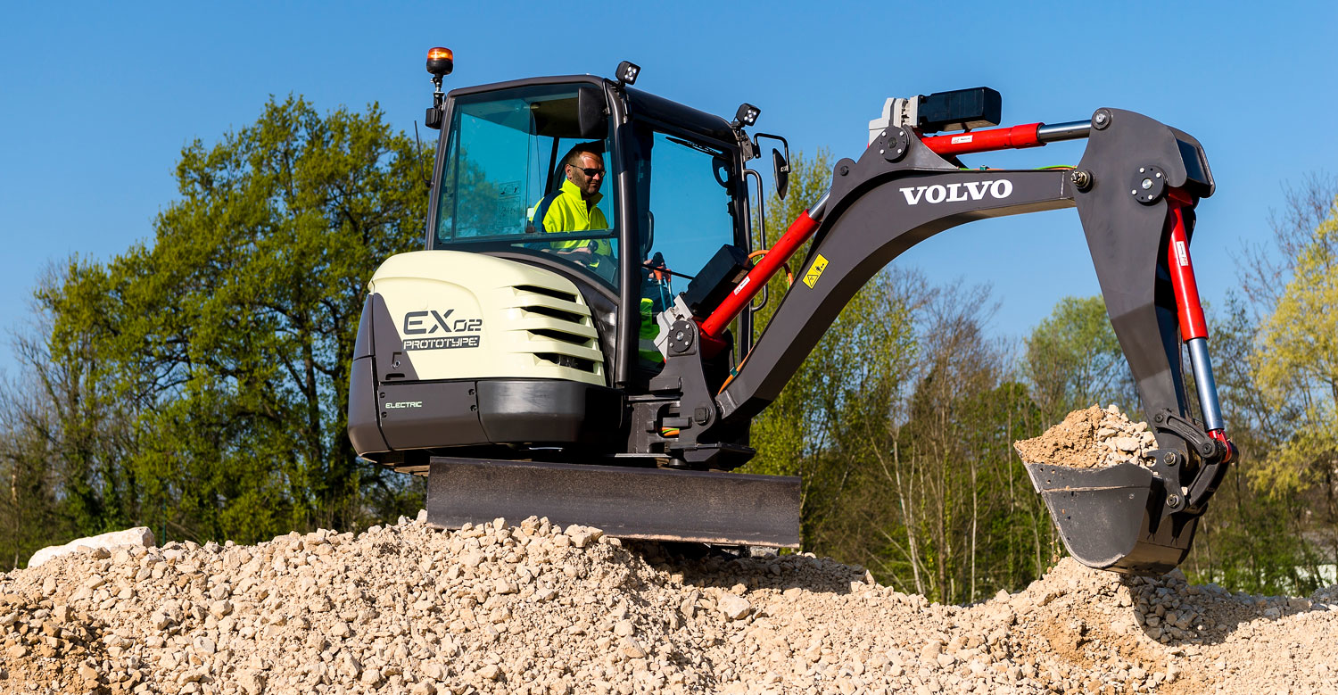

Volvo Construction Equipment’s concept vehicle, the EX2, is an all-electric compact excavator. According to the company, it delivers zero emissions, 10 times higher efficiency, and one-tenth the noise of its conventional counterparts. Instead of a combustion engine, it carries two lithium batteries, which store 382 KWh, enough for eight hours of digging. And instead of hydraulics moving the arm, electromechanical linear actuators handle the task.
