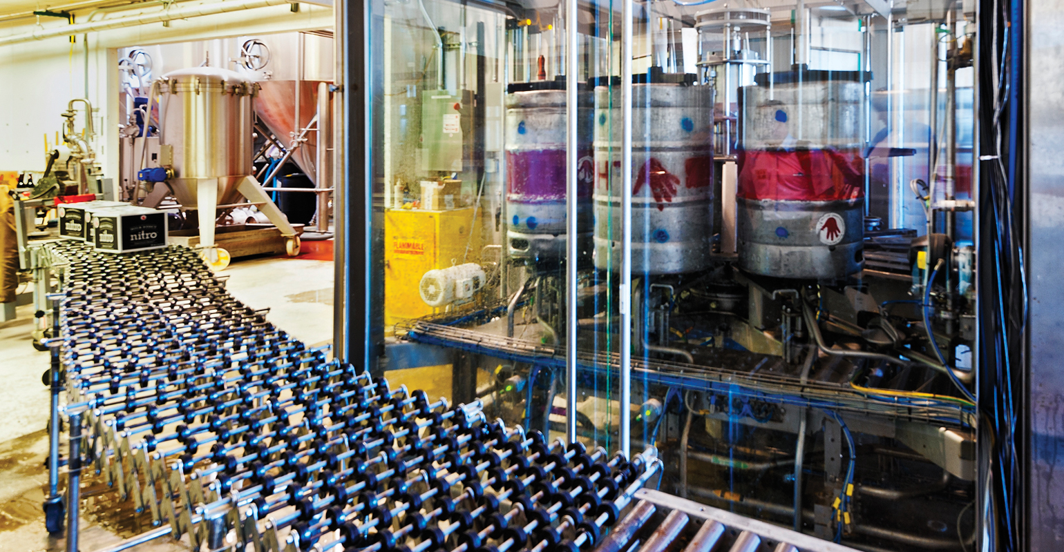

Microbrewery
A craft brewery in Colorado needed to increase production capacity and efficiency, but had no room for a new production line. They solved the problem with a rotary kegging machine. Linear actuators on top of the machine control the motion of the kegs through the process.
These actuators integrate the valve, flow controls, cushioning, and sensors in the same package as the actuator, eliminating multiple valve islands, external components, tubing, and accessories. This combined with a clean external package not only saves space on the machine, but allows for easy, thorough washdown as required by this application.
The cleanline profile and reduced tubing of the integrated actuator and valve control cylinder mounted on top of this rotary kegging machine save space and make washdown easy. (Photo copyright Norgren Inc.)
