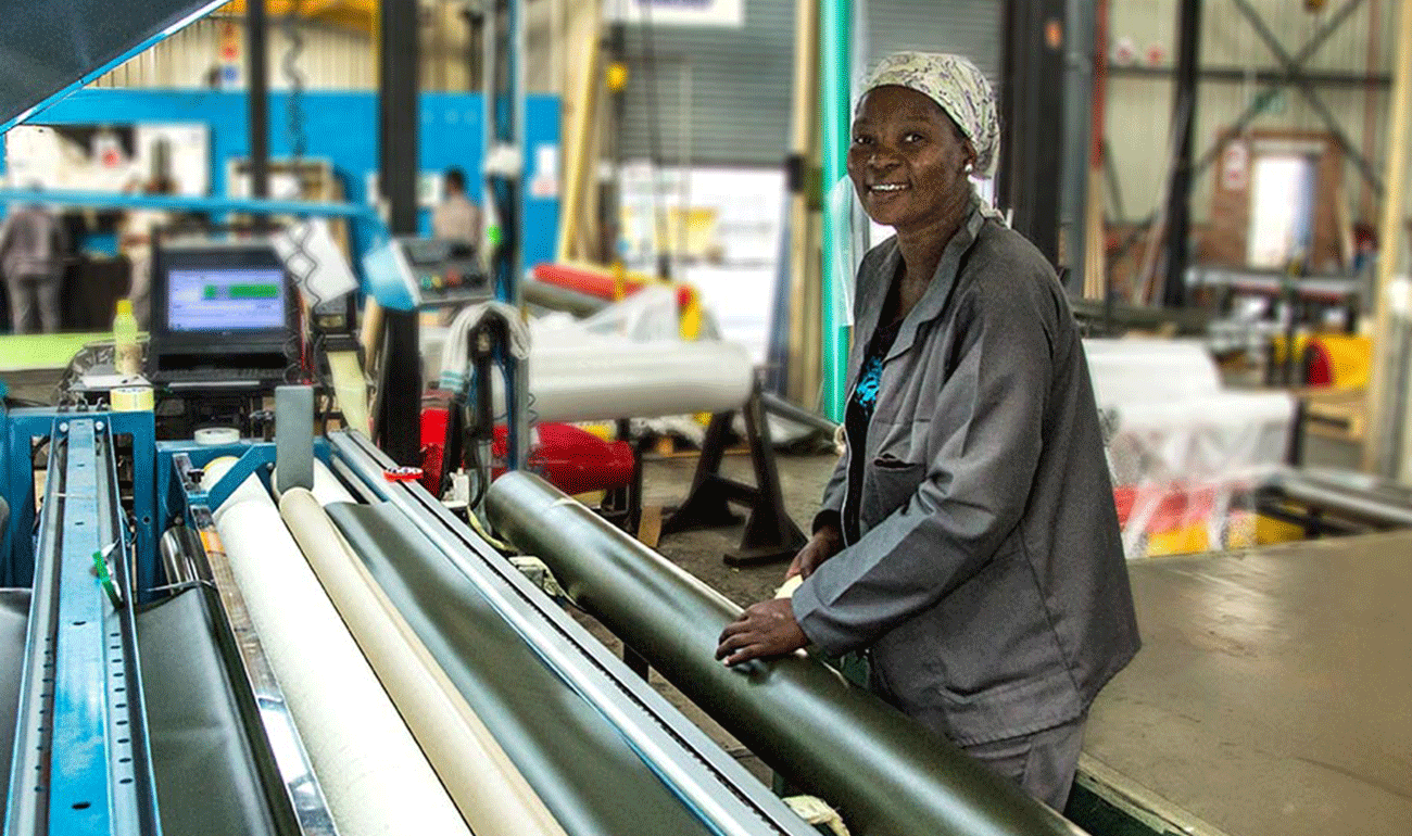

Arthur Dowson Ltd. is a laminating and coating factory that creates products such as dam linings, billboards, butchery aprons, upholstery materials, placemats, tents, tarpaulins, and jumping castle fabrics. The production process starts with the fabric roll shaft, with the raw material around it resting upon the support bearings. Once it receives the coatings on the one side, the material is rolled onto another fabric roll shaft supported at the other end of the production line, which is also supported by bearings.
The Arthur Dowson company laminates and fabricates different cloth materials, including upholstery materials, placemats, tents, and tarpaulins, using large fabrication rollers.
After that, 1000 meters of the roll is typically transported back to the start of the production line, so that the reverse of the material can also be coated. The process is then repeated, and the roll of fabric gains in weight and volume as it receives additional coatings. The fabric rolls can weigh up to two tons after coating, with some clients requiring more coatings that result in an even greater fabric weight.
