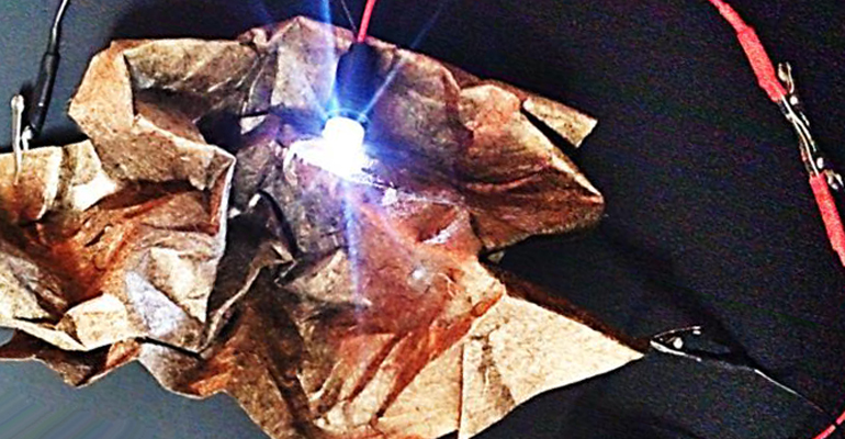

Using a simple layer-by-layer coating technique, researchers from the U.S. and Korea have developed a paper-based flexible supercapacitor that could be used to power wearable devices. The device uses cellulose fibers in the paper coated with metallic nanoparticles, creating supercapacitor electrodes with high energy and power densities—and the best performance so far in a textile-based supercapacitor. They even work when crumpled (see top image).
Implanting conductive and charge-storage materials in the paper creates large surface areas that act as current collectors and nanoparticle reservoirs for the electrodes. Tests show that capacitors fabricated with this material can be folded thousands of times without affecting conductivity.
