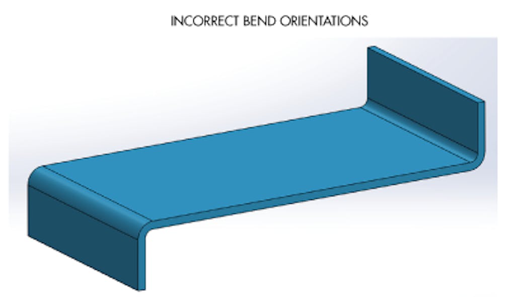

Bends
Sheet-metal brakes bend sheets into a part’s desired geometry. Bends in the same plane should be designed in the same direction to avoid having to reorient the part during manufacturing, which will save money and time. Another trick is to keep the bend radius consistent to keep parts more cost-effective. Thick parts tend to become inaccurate, so they should be avoided if possible.
Rule of thumb: To prevent parts from fracturing or distorting, make sure to keep the inside bend radius at least equal to the sheet’s thickness.

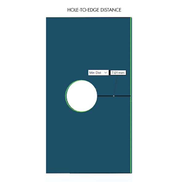

Holes and Slots
Holes and slots may become deformed if positioned near a bend. The minimum distance that holes should be placed from a bend is a function of the material thickness, bend radius, and the hole’s diameter. Holes should be at least 2.5 times the material thickness plus the bend radius away from any bends. Slots should be placed 4 times the material’s thickness plus the bend radius away from the bend.
Be sure to put holes and slots at least twice the material’s thickness from an edge to avoid a “bulging” effect. And holes should be separated from each other by at least 6 times the material’s thickness.
Rule of thumb: Keep hole and slot diameters at least as large as the material’s thickness. Higher-strength materials require larger diameters.
