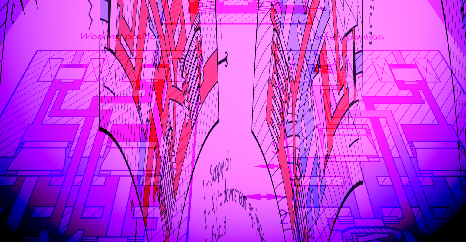

Valves with internal cross monitoring eliminate the extra step of electrical signaling. They are pneumatically self-monitored, and as 3/2 normally closed valves, will always exhaust when a fault is detected, depressurizing the system even if no power is available. They also will prevent restart as long as a fault is detected.
Illustrated are solenoid-activated safety valves with internal cross monitoring.
The solenoid valve highlighted in this article diagrams a two-channel safety valve with cross monitoring. In basic position, no compressed air (red color in the figure above) reaches the downstream equipment. In working position, the equipment is powered. The valve moves into safety position if one channel faults; for example, control is out of balance, a solenoid malfunctions, or the valve is contaminated. In this case, rather than keep the process running without redundancy, the valve automatically shuts it down without requiring a signal to the PLC.
