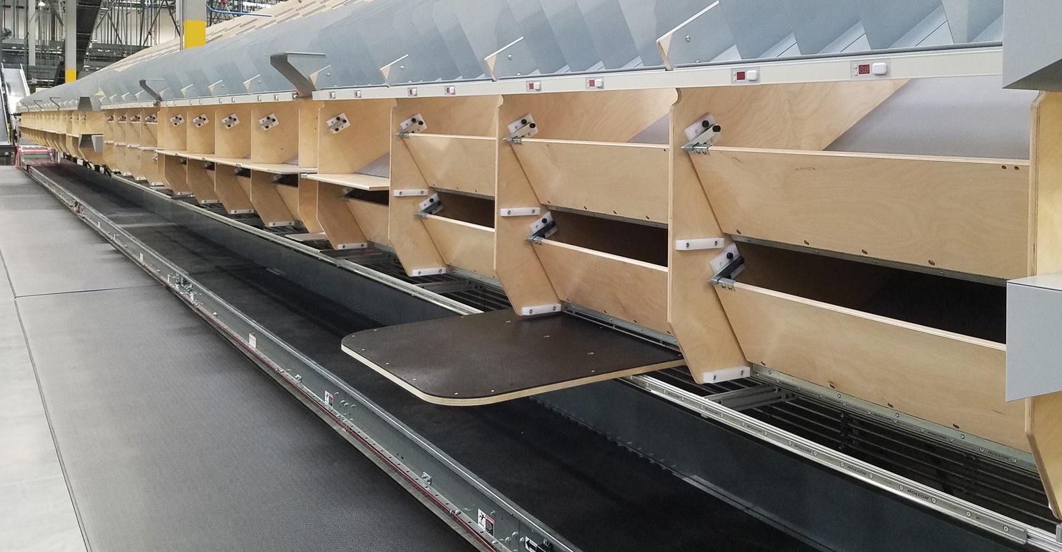

Systems Integrator N-III
When it comes to automation technology, robot-automated guide vehicles and pick-and-place systems are just as important as the smaller, simpler structures that are required to interface with the high-tech systems. Systems integrator N-III, Inc. devised a simple large-scale solution to improve the efficiency of an existing warehouse automated packaging-staging module.
Each module consists of four chutes that feed packages from the top of the system down to the station operator. The operator is notified of an order and, from there, can pull it out, package it, and place it onto a conveyor belt beneath the chutes. N-III wanted to incorporate support platforms onto the design of this existing structure that operators could use to box the finished orders.
N-III simple design solution was creating tables made of strong ply, which they capped with an ABS plastic. These ABS “tops” were water jet cut and served as the template to rout the tables from the ply. The tables were then mounted onto a linear slider, which was mounted simply into a standard aluminum extrusion. The workers could then slide a table along the length of the chutes when needed. There is one table per four modules and the tables can travel across the different modules (up to 12), maximizing design flexibility and minimizing the number of tables that need to be installed.
The design considerations taken by N-III related to finding an appropriate structure that could handle the moment load created by the weight of the package. N-III engineers ran a finite element analysis test to analyze and compare system stress under loads using a 1 × 1 and 1 × 2 lateral bar; they found that the 1 × 2 bar could handle the high loads of the heavy packages. Also the engineers had to figure out a way to attach the tables to the structure without any additional drilling or the use of T-nuts. T-nuts would have been a difficult installation task and more expensive than the aluminum sliders.
The engineers designed pre-drilled and tapped bars that, once inserted into the extrusions, aligned with the track’s 4,000 existing bolt holes. Lastly the use of the linear motion bearings provide the machine builders a self-aligning system. The Compact Rail by design is tolerant of misalignment and can absorb alignment errors in one or two axes due to its rail geometry. They can rotate up to 2 deg. relative to the rail without affecting functionality or increasing wear. This provided design freedom and cost reduction for the system.
