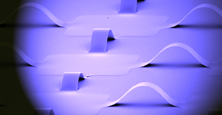

To make the entire system stretch, you start with a silicon wafer. This wafer leads to thin Silicon ribbons. Then polydimethylsiloxane (PDMS), a silicon-based organic polymer, is strained and bonded to the original thin silicon ribbons. Once the PDMS is removed, the thin ribbons are shown to become wavy. This provides a high semiconductor coverage area, but the wafer stretches less than 20%.
Larger “waves” can be obtained to increase a circuit’s ability to stretch (>100%). This is accomplished by reducing coverage areas to about 25%. Once technology is stretchable, there is no end—including making sci-fi a reality. For example, in the show “Black Mirror,” multiple episodes depict eye contacts that work as cameras or can add augmented reality to a person’s vision. In the show, these contacts allow the character to record, share, or play back everything they’ve seen and more. This may have been inspired from the August 2008 issue of the science journal Nature. That issue featured a paper on an electronic camera that is able to take the shape of a human eye, one that could someday work on a contact lens.
