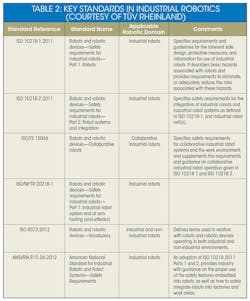

Another recent study from TÜV Rheinland (http://www.openskycorp.com/resource-center/blog/industrial-robotics-cyber-security/) highlights not just the potential attacks against robots from cyber attackers, but the standards and a checklist of actions users can utilize to protect their robotic equipment. Industrial robot manufacturers and operators need to review all cybersecurity risks. Once the risks have been determined, they can implement the following standards to help them prevent attacks.
The following are checklists from TÜV Rheinland that can be performed by manufacturers, integrators, and operators alike to help secure better robot security.
