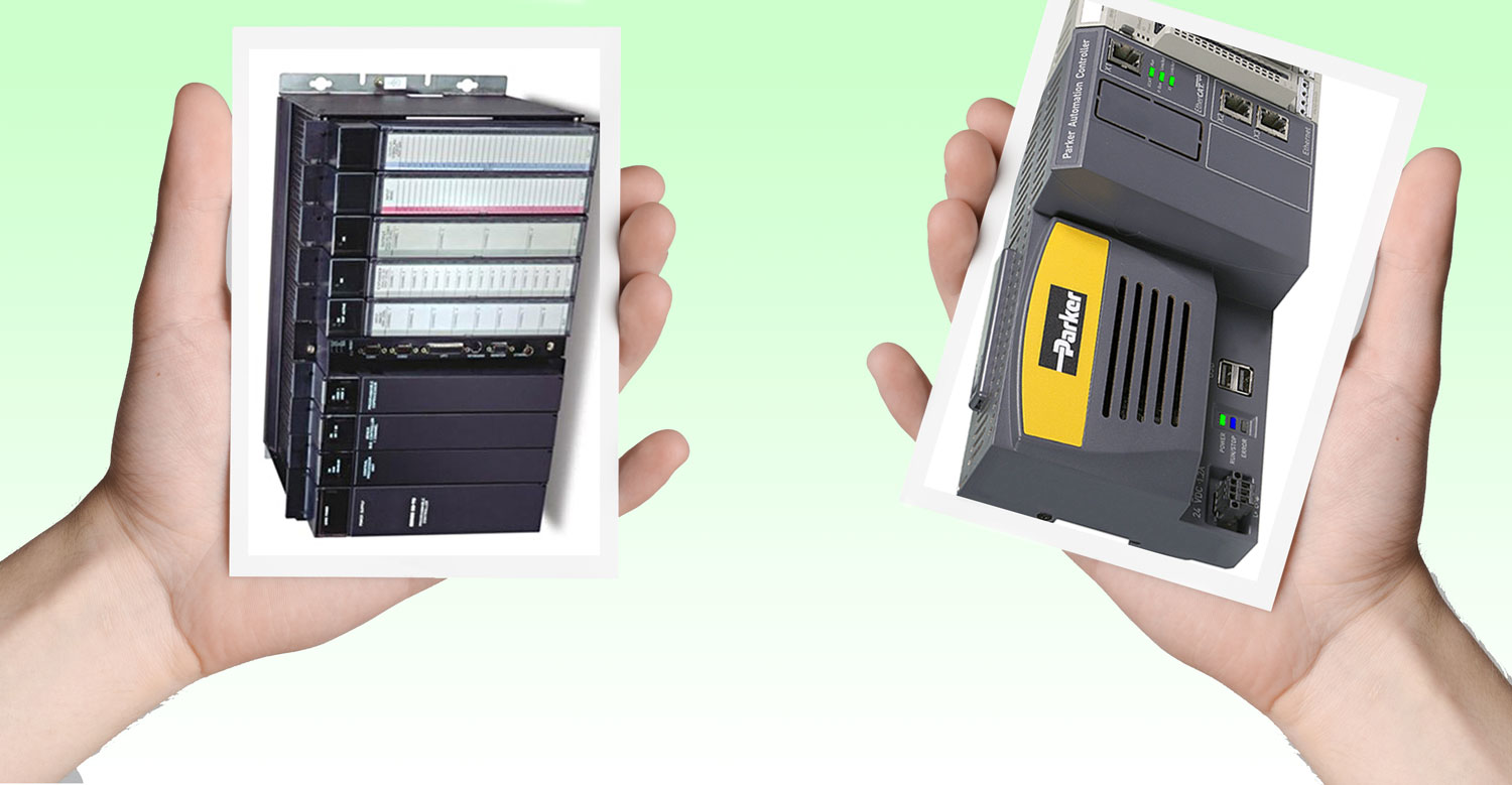

Programmable logic controllers (PLCs) and programmable automation controllers (PACs) are industrial computers constructed and adapted for manufacturing environments. These computers are the brains of a manufacturing operation, providing highly reliable control of automation equipment.
PLCs and PACs are very similar to each other as they both perform the same essential functions. And, with modern technology, their differences are becoming more blurred. All automated systems are built with a PLC or PAC to control individual machines or stations. Additionally, the computers can be programmed to control a group of machines or stations.
The most notable difference between PLCs and PACs is their programming interface. PACs are more intricate, using C or C++. PLCs, on the other hand, are programmed using ladder logic, a programming language that employs symbols representing an electrical schematic of relays. These programming differences create distinctions in the architecture and capability between the two computers.

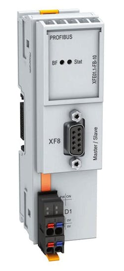

PACs have an open architecture and incorporate modular design. This helps an array of devices, networks, and systems communicate and operate with each other. PACs are used to communicate, monitor, and control equipment across multiple networks and devices. This is possible because they utilize standard protocols and network technologies such as Ethernet, OLE for Process Control (OPC), and Structured Query Language (SQL).
Thanks to their modular design, PACs help simplify system expansion processes. Adding or removing components is easier to execute. PACs have the ability to monitor and control thousands of I/O points in addition to offering tag-based programming. With tag-based programming, a single tag-name database is used for development, and these tags can be assigned to a variety of functions before being tied to a specific I/O.
PACs provide more flexibility in programming, larger memory capacity, and better scalability for future expansion. They are particularly useful for systems with a high percentage of analog I/O. Oftentimes, they will be implemented in systems with extensive network interface requirements and systems with direct user interaction requirements.
