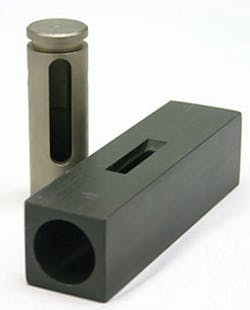

Some parts (like that shown) are subject to line-of-sight process restrictions, or they require special equipment to process them.
Most common with electroplating, anodizing, spray coatings and physical-vapor-deposition (PVD) methods, “line-of-sight” is one of the most frequent process limitations encountered by engineers. In general, the rule with these processes is “what you see is what you can coat.” Engineers need to consider a more suitable immersion process for parts with hidden surfaces that require treatment.
With line-of-sight applications, the engineer is usually limited to between one and one-and-a-half times the diameter for the coating’s depth to uniformly penetrate down the hole. That’s due to the limited throw of a line-of-sight process. Thus, parts with deeper holes will not have a uniform coating thickness. This could become a significant issue for parts with tight tolerances, unless special anodes are developed for these deep-hole applications.
Parts with deep blind holes are subject to air pocketing and may require special fixtures or position to ensure continuous coating.
Air pockets, or pocketing, which is air trapped in the cavity of a part, is an issue often found with immersion processes such as anodizing and plating. If a critical surface needs a coating, the engineer must ensure access to that surface so the coating vendor can remove the pockets. Pocketing reduces the coating efficiency, too, because the part often has to be oriented at different angles and then maneuvered to remove the air. Intricately designed parts are more susceptible to this issue, so engineers also need to consider designing in relief holes to allow the air to escape.
