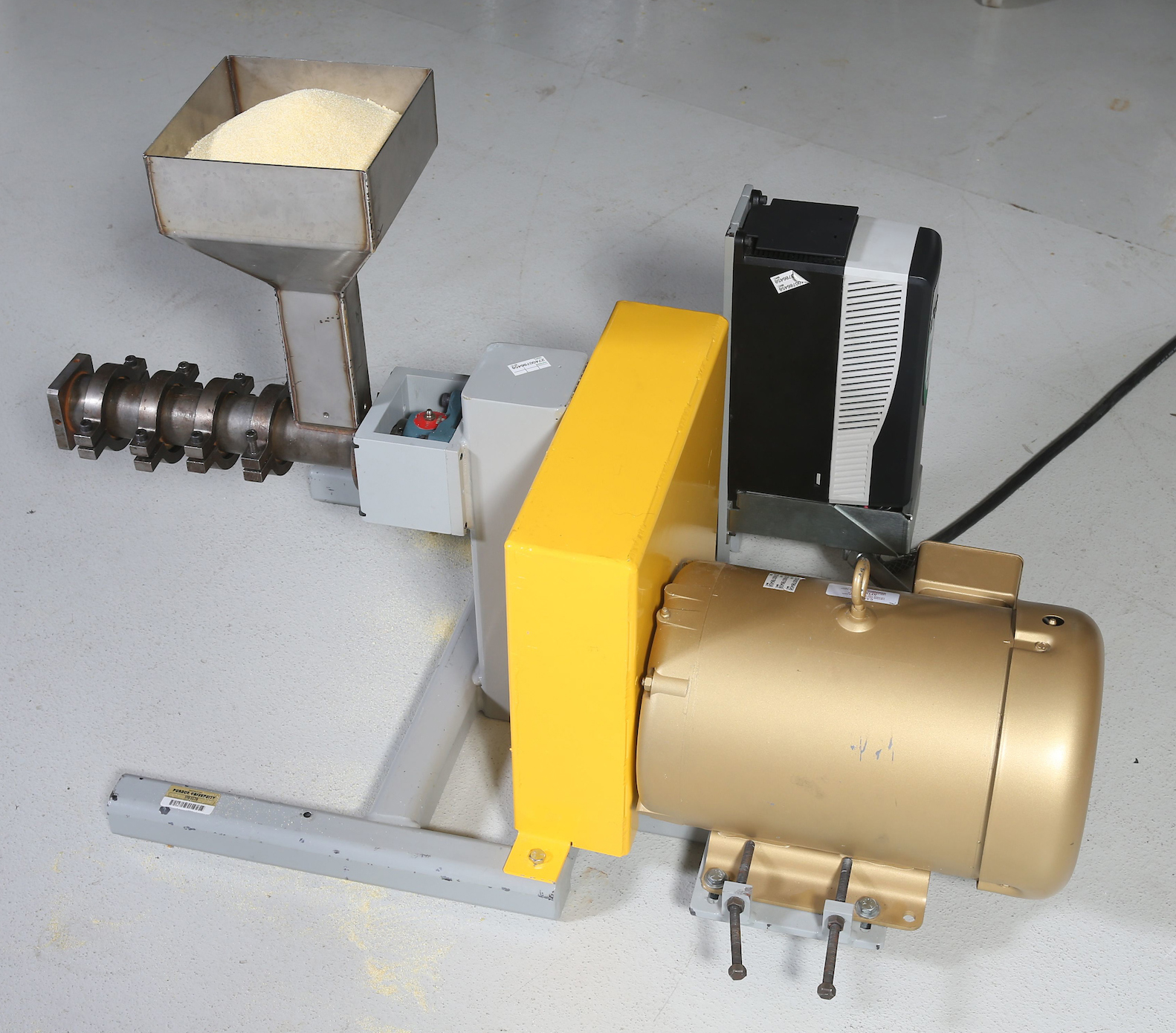

NASA commissioned Purdue University researchers to develop a lightweight extruder that could be used to process various grains, including soybeans, during a mission on Mars. Many puffed cereals and snacks, as well as pastas, are made using extrusion.
Purdue’s prototype device uses friction to heat and cook the soybeans, and then separates oil from the soybeans. The resultant rope-like substance can be dried to make flour or combined with other products to make pastas and snacks. The soybean oil can also be used for salad dressings or other cooking needs.
“NASA wanted a way to process food grown on Mars because it is so expensive to ship food there—something like $200,000 per kilogram,” said Martin Okos, a professor of agricultural and biological engineering and one of the project’s leaders. “The biggest challenge we faced was scaling down, but we developed an extruder that is down to about 60 lb. NASA would like an extruder to be 100 times smaller, so more research is needed to reach that goal.”
Before the extruder makes its debut on the red planet, however, it has found a more important use boosting food production capacity in Niger, Senegal, and Kenya. After working on the NASA prototype, Okos and graduate student Amudhan Ponrajan modified the extruder to work with other types of grains and legumes, including pearl millet, teff, corn, rice, wheat, sorghum, chickpeas, and lentils, which are more widely grown in developing countries.
Those foodstuffs can be milled/ground, mixed with water, and pushed through the extruder, which uses a screw to force the product through a channel where friction heats and cooks the grain, just like its Martian counterpart. And the output can be dried and ground into flour that, when mixed with water, results in an instant porridge.

The modified extruder for Africa was designed to be relatively inexpensive. Large-scale extruders in U.S. facilities cost up to $200,000 and can process hundreds of kilograms per hour. The Purdue-modified extruder produces 35 kg hour, but costs only $20,000.
In addition to cost reductions, the extruder had to be modified to work with various crops grown by African farmers. The speed and size of the screw components in the device determine how much heat is created through friction. Soybeans are high in oil content, so they need more friction to cook them. Millet, sorghum, and maize are low in oil, so the same amount of friction would burn those grains.
