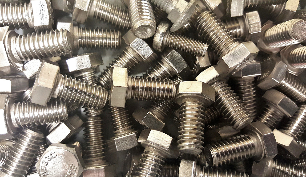

These fasteners undergo strict regulations for several reasons, but before we get into those, let’s take a look at some of the more common hardware types and what makes them aviation/aerospace-grade. Screws, nuts, bolts, pins, and collars (and a ton of specialty types) are the most common fasteners that can be found in any mechanic’s toolbox; the difference between these and those found at Home Depot is quality. They need to handle the rigors of high-stress, pressures, and temperature extremes without risk of failure.
