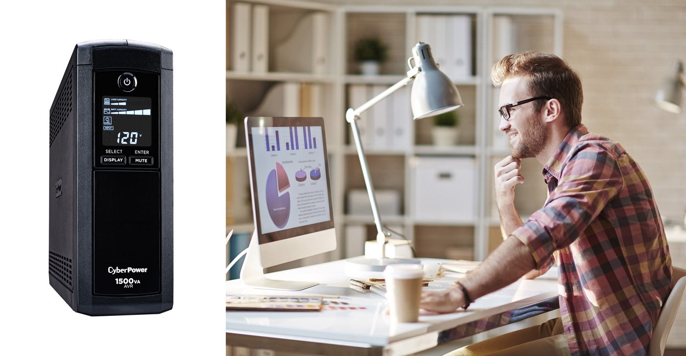

Engineers at CyberPower were recently tasked with updating and redesigning the company’s popular UPS. After some discursions, they came up with a list of design goals for their new UPS, the $140 CP1500AVRLCD:
  • Longer runtime
  • Extended operating temperature, especially on the hot side
  • Quieter operation
  • Improved user controls
  • Better ventilation
  • Reduced need for service/support
  • Increased reliability
  • Easier to manufacture
  • Longer component and subsystem life expectancy
  • More battery-backed power outlets
  • More surge-protected (not battery-backed) power outlets
  • User-configurable monitoring and settings
  • More intuitive identification of power outlets
The original UPS was somewhat more squat than what users expected to see in a UPS. The short UPS also made it difficult for users to read the controls because they often put the UPS on the floor. This was another factor pushing for a taller housing with a larger interior volume. So one of the first design decisions was to go from a housing that measured 4 × 14 × 9.75 in. (w × d × h) to one that was 3.9 × 14.25 × 11 in. Right off the bat, the larger side panels let the designers put bands of perforations at the top and bottom of the panel for better ventilation, which helped in extending the unit’s operating temperature range and in quieting the noise. The larger size also freed designers to consider a wider array of changes so they could get comparable or better performance at a comparable price point.
Power line monitoring: The original product had a blue-background LCD status screen, so there never was a much of a power margin for the 10-year old display. Now, with more choices available, designers have pared back the display’s power requirement. But they improved display legibility by replacing the LCD with a black-background display with much higher legibility. The engineers realized that users don’t look at the display much except during setup, and even user interaction with the UPS software is infrequent. So they decided against materially enhancing the display’s size, brightness, or resolution, all of which should satisfy the vast majority of users.
MOV surge protector components have seen continuous improvement over the years, and the older UPS had kept pace with them, so there were no significant benefits from updating MOVs. However, some internal components were significantly better than the older ones and contributed to reducing heat generation and power consumption, thereby helping improve reliability and longevity.
Batteries: Longer running time was a primary goal for batteries, so designers turned to improving the runtime for sealed lead-acid cells. In the end, the new battery had dimensions identical to the previous one, but with slightly better performance specs and a design that simplified recycling.
One challenge with the batteries involved their operating environment. UPSs often end up in confined spaces, such as behind a desk or on a bookshelf. In the summer, and especially during power failures and air conditioning outages, it often gets hotter inside the case than the batteries were designed to withstand.
The designers came up with a battery that has the same footprint as the previous one, with only a slight weight penalty: two 6.06-lb. batteries instead of two 5.73-lb. ones. The extra weight for an identical volume is easy to attribute to beefier plates.
Overall, the battery pack’s extended operating temperature went from a peak of 40°C (104°F) up to 45°C (113°F). The battery pack’s capacity also increased, going from eight to nine amp-hr. This translates into an improvement in runtime under half load from 11 to 12 minutes.
The inverter was updated, going from a half-bridge design to a full bridge, and it was made more reliable with a longer operational life.
Rear power outlets: It’s common for UPSs to house two sets of power outlets with all outlets providing surge and EMI/RFI protection, but only one set also offering backup power. One important challenge for CyberPower was how to help users distinguish between the two.
The previous model had four closely set outlets on the right without battery backup and three closely-set backed-up outlets, plus a fourth with wider spacing to accommodate a power adapter. All eight outlets were black.
The new design features five closely spaced black outlets on the right with no battery backup but surge protection, plus one more with enough space around it to accommodate a power adaptor. There are five light gray outlets on the left with battery backup and surge protection, along with a sixth outlet spaced for a power adaptor.
