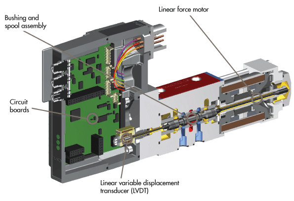

To capitalize on this desire to digitally upgrade a mill's motion-control systems, Moog engineers have developed four new direct drive valves (DDVs). These new valves have internal electrical contacts that resist extreme vibrations and extra potting on critical components. Flow ranges from 1 to 42 gpm and maximum supply pressure is 5,000 psi.
The advantages customers experience when upgrading to digital valves include better static and dynamic performance via higher resolution, and better pressure control. The new model valves also offer diagnostics and internal valve error handling. In addition, maintenance is reduced because the valves do not have hydraulic pilots, so they better resist contamination and there are no small orifices to clog.
