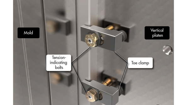

In application, systematically eliminating wastes from bolting processes leads to improvements. Let’s take an example from industry: A Tier 1 injection molding company struggled to consistently secure large molds in their presses. The company wanted a better way to protect machine operators and equipment.
Toe clamps fastened to a vertical platen with tension-indicating SmartBolts hold the mold tightly in place. The bolts let operators know the joint is good and will hold the mold safely in place.
One major concern was determining how many toe clamps were needed to properly secure the molds, according to the tooling manager. The number of clamps used depended on recommendations from the engineering department, and it based its recommendations on the mold’s weight and access points available on the mold. If a mold couldn’t be clamped in an ideal place, additional toe clamps were used to compensate. In addition, stripping out the threads of the unhardened platen was frequent because high strength bolts were used without adequate thread engagement. Fluctuations in mold thickness, clamp type, and bolt lengths made it difficult to control engagement. Furthermore, impact guns and torque wrenches were used interchangeably to tighten bolts. The factory operated 24 hours a day and the company wanted more efficient operator rotations. On top of this, molds still slipped out of proper position.

As a result of the bolting wastes evaluation, the company determined that tension-indicating fasteners would be a lean solution. DTI SmartBolts let the tooling manager set a specific tension value suitable to the application. The SmartBolts would signal a “tight” black color when proper preload was achieved. If preload was lost, the indicator displayed a bright red “loose” signal.
Once in use, technicians could now be confident the right amount of clamp load was being applied, so extra fasteners were unnecessary. This directly solved the 2nd bolting waste of improper preload. Because SmartBolt accuracy does not depend on torque, they can be installed with a breaker bar, torque wrench, or impact gun. In fact, impact guns can be adjusted to the right pressure based on the bolt’s visual indicator. Correcting defects and rework required a discussion on thread engagement. The company adopted the rule of thumb that at least one diameter of thread engagement is needed for steel and 1.5 diameters of engagement for aluminum. Improving standardization among clamps, washers, and bolt lengths was also recommended through a “5S” program. (5S is a workstation organization method consisting of Sort, Set in Order, Shine, Standardize, and Sustain activities.)
Now, with proper thread engagement and preload control, thread stripping and bolt breakage were dramatically reduced. The delays experienced were also reduced by eliminating the risk of thread stripping and the need for torque wrenches at final installation. Operator changeover time was reduced by using SmartBolts’ visual indicators. The visual indicators acted similar to an Andon, a system used in Lean Manufacturing to alert maintenance staff of problems on the line. Finally, rapid inspection of bolts by new shift operators minimized time spent between platens, helping to provide a safer and more efficient work environment for all employees.
