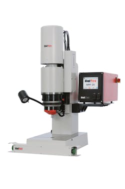

An EcoLine orbital riveter from Baltec uses 2 to 7 bar of pneumatic pressure to form heads on rivets. Maximum riveting force ranges from 20 kN on the Model 20 to up to 35 kN with the Model 35.

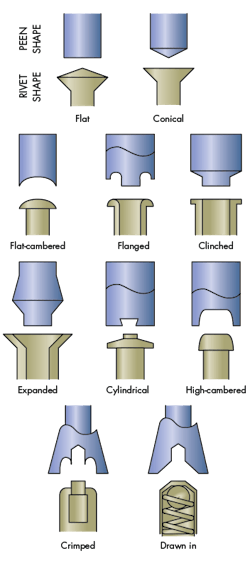

Peens are shaped with the final shape of the finished part in mind. Specific peens have been designed to produce conical, flat, eyelet, and crown heads. The forming tools are usually made of M2 drill-rod steel and heat treated to a Rockwell C hardness of 60 to 64. On the riveting or forming machine, they are held in place by a setscrew and can be quickly changed.

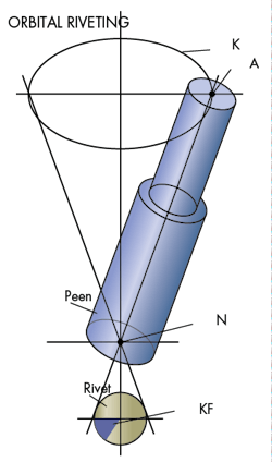

In orbital riveting, the changing longitudinal axis, A, of the peen describes the surface of a cone, K, whose tip, N, lies within the rivet. The peen works on a crescent-shaped contact surface, KF, and pushes metal along in front of that area.

The peen’s shape determines the shape of the rivet head. Here are some of the more commonly used tools and resulting rivet heads.

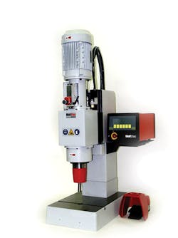

Orbital-riveting machines need less force than impact riveters. Pneumatic versions, for example, exert 1,000 to 7,500 lb. of force, while more powerful hydraulic orbital riveters can exert 6,000 to 50,000 lb. of force. Precision orbital machines spin the spindle at about 1,700 rpm. Heavier-duty machines run at 900 to 1,200 rpm.

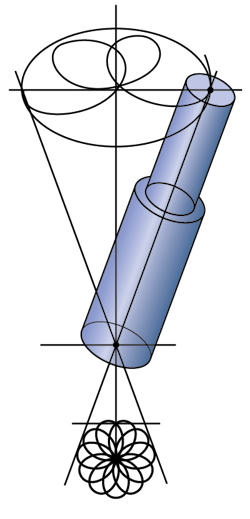

Rivets can also be created using radial forming, which is similar to orbital forming. With radial riveting, though, a punch rather than a peen rotates around the workpiece, tracing out an 11-sided rosette path (actually a hypocycloid, much like what could be created with the Spirograph toy). It gently deforms the material. There is little axial force and the material predominantly flows radially.

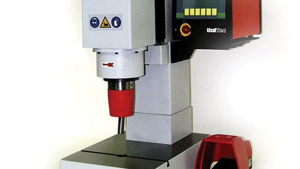

The RN Series of radial-riveting machines from Baltec exert from 2 to 50 kN of force.

In radial riveting the, tool does not spin, but rather is moved around the rivet, pushing small amounts of metal into shape gradually to form the finished head.
