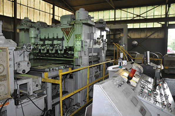

The Voss leveler represents one stage in the Hagerty Steel cut-to-length line. Virtually all of the machine hardware was still useful, and only the motion-control system needed to be retrofitted.
An example of a control system retrofit that improved machine productivity was recently executed by Hagerty Steel, East Peoria, Ill. Hagerty added a new control system for its heavy-gauge steel coil cut-to-length line; it had been upgraded three times previously over the years, but was still not cutting sheets precisely. “One of our customers requested that we tighten our tolerance, and with the old system it was impossible,” says Thomas Boon, Hagerty Steel Maintenance Manager.
To fix the problem, they needed an electronic motion controller that could perform complex multi-axis synchronization tasks. Based on experience with an upgrade of another machine at the Hagerty plant, Delta Computer Systems’ RMC150 eight-axis motion controller was deemed the best choice. The controller has several built-in multi-axis gearing, camming, and synchronization functions that enable multiple slave motion axes (in this case, controlling multiple different-sized roller drive motors) to produce tightly controlled motion in relation to that of a master axis.
The RMC75 (left) two-axis motion controller and RMC150/151 (right) eight-axis motion controller can control and synchronize multiple axes simultaneously.
Hagerty’s controller upgrade did resolve the production quality issues. “Whereas the old machine was only able to produce steel sheets to within tolerances of approximately ±1/4 inch, and out-of-tolerance material was wasted, we were ultimately able to tune the machine to achieve the required dimension to within 1/1000 of an inch,” says Glenn McIntyre, Controls Engineering Manager at systems engineering firm Advanced System Integration & Control Inc. (ASIC), West Chester, Ohio. “And we were able to get the system to settle down quickly so our customer could fire the shear more quickly and increase their production rate.”

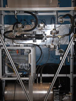

As with Dril-Quip in the previous section, Innkeeper bases its automotive test controls on two key elements: an electro-hydraulic motion controller to deliver real-world stresses, and a PC with a standardized user interface, which in this case can be used to set up and control a wide range of automotive testing applications and gather test data.
Innkeeper’s transmission cooler test system uses a hydraulic cylinder like a syringe to apply high-frequency pressure pulses to the product under test, mimicking real-world stress conditions.
One application developed by Innkeeper tests heat exchangers used in transmission coolers. The system uses a servo hydraulic cylinder acting like a syringe to inject high-frequency pressure pulses into the test specimen. In this manner, the machine can accurately reproduce the pressure fluctuations that occur under actual vehicle conditions. The cylinder is operated via a high-performance servo valve, which is in turn driven by the motion controller.
Different Innkeeper test systems use RMC75 (1-2 axes) or RMC151 (2-8 axes) motion controllers, which connect to the PC via Ethernet and perform all of the closed-loop control, limit checking, and cycle counting. The controller holds the custom test profiles, allowing the PC to stay out of the loop and focus on monitoring/acquiring data.
The “series controllers provide us with great control on all tests ranging from quasi-static through 50-Hz operation, with a loop update rate between 1000-4000 Hz and supporting data acquisition of all signals up to 1000 samples per second per channel,” says  Kevin Kretschmann, Innkeeper principal. “We can build and the accurately control any waveform or combination of waves within this range.”
