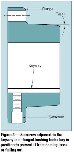

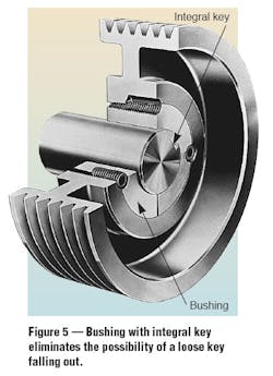

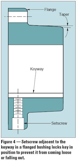

In most flanged bushings, a setscrew in the flange, Figure 4, tightens against the key to prevent it from working out of the keyway. This feature is especially useful for applications subject to vibrating or pulsating loads and in vertical shaft applications. One type of bushing has an integral key that is formed as part of the bore, Figure 5, so there is no separate key to come loose. Both types of bushing are popular in vertical shaft installations.

• Setscrew keeps key in place, which is good for vertical shafts and for high horsepower drives with large pulsating or vibrating loads.

• There is no setscrew to lock the key in place.
