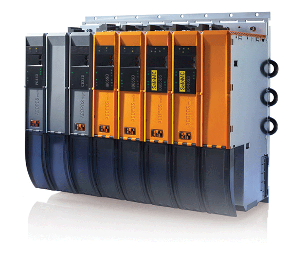

Safe Motion Control (SafeMC)
SafeMC is the combination of safety-rated software and hardware to ensure safe operation, at the same time expanding the capabilities of a motion system —e.g., avoiding unnecessary and costly stop and restart procedures that can involve re-homing and resynchronizing linked axes. This is achieved through constant self-monitoring to keep within defined operating parameters as defined by a risk assessment. The risk assessment is necessary to identify the hazards of a machine and to determine the safety measures that should be implemented to protect operators and maintenance personnel.
The ACOPOSmulti_white is a rack of servo drives used to control the motors for these functions, as well as to monitor the encoders for position and velocity. Should any of the limits be violated, the systems go into a safe state.
The hardware is made up of functionally safe-rated encoders mounted to servo motors and safety- rated servo drives. The safe encoders are specially mounted to the motor to prevent misalignment and slippage that would affect the accuracy of the position feedback. The feedback is sent redundantly to the drive with checksum to prevent corrupted data and ensure its accuracy. The safe servo drives have permanent redundant feedback cards to ensure that the drive evaluates that position correctly. On the software side, the PLCopen Safety standard is the backbone of safety-rated functionality. It ensures that the software functions, once the full safe application has been verified, fall within applicable machine safety standards and serves as a measuring stick for the safety of a machine during a risk assessment.

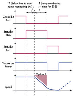

Safe Stop 1 (SS1)
According to IEC 61800-5-2:2005, “SS1 initiates and monitors (or controls)...deceleration...within set limits to stop the motor and initiates the STO [Safe Torque Off] function when the motor has stopped; or initiates the motor deceleration and initiates the STO function after an application specific time delay. The STO function as defined by the same standard: Power, that can cause movement …is not applied to the motor or has been removed.”
Safe Torque Off is the most commonly used safe-motion function, as it is considered the safest form of stopping through complete power removal from the motion system. It is also the failsafe mechanism built into every other safe motion function.
The purpose of this function is to cause the motion system to stop according to a Stop Category 1, as defined in the standard EN60204. This FB allows a user to initiate a user defined controlled stop (speed-controlled, torque controlled, etc.) to quickly decelerate a single-motion axis before removing power to the motor. The FBs safety function is twofold: First, it monitors the speed of the axis. When it reaches standstill, it sets an output for use in the application code and initiates an STO function on the drive. Secondly, it has a timer that is monitored alongside the axis velocity; if the axis is not at standstill within an application-specific time period, it assumes the drive is unable to complete its request for a controlled stop. The safety system then tells the drive to initiate an STO function to ensure the motor is not powered and will come to a stop.
Note: The FB does not execute the stop function. The stop function is the responsibility of the drive system.
A good example application for the SS1 function would be for any roll-to-roll process, such as a rewind stand. The web (paper, metal, rubber, textile, etc.) has an operational or safety issue (like a partial tear, complete web break, etc.), and the operator activates the E-Stop command. In a traditional system the power to the motor is removed via an STO circuit on the drive and the spool would spin out under its own inertia or require a large mechanical brake to slow down the load.
With the SS1 function in place, the operator would command a stop via the E-Stop. Then, using the controller and a piece of software, a stop command would be sent to the drive with a high deceleration. The SS1 function would monitor its timer and, after the defined period, it would initiate the STO circuit on the drive. This would considerably shorten the time required for the spool to come to a stop, and would greatly decrease the wear on an external mechanical brake—if it did not remove the need for said brake entirely.
