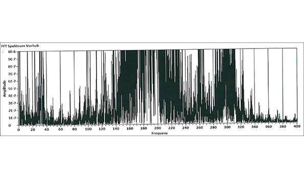

After the team measured torque and sound emissions and performed appropriate FFT analysis, it determined that microscopic corrugations on the shaft thread significantly influence the overall sound emitted by running ball-screw drives.
1. Torque before: The graph shows a huge variation in dynamic torque along the length of the conventional, untreated shaft.
2. Noise before: The graph shows a large peak in the sound profile near 265 Hz.
When the researchers looked at the surface of the shaft’s smoothed thread under magnification, they noticed tiny facets measuring around one half of one thousandth of a millimeter (0.5 µm), about the wavelength of blue light (430-500 nm). The facets are the result of vibrations in the grinding wheel when it ground the shaft. The team determined they were the primary source of the annoying noise when they noticed the noise’s frequency peak at 265 Hz corresponds exactly to that predicted from the size of the facets and the rotation rate of the drive’s shaft. When the bearing balls roll over the small bumps or facets, they slip a small amount, causing the disturbing whistling noise

4. Noise after: The noise at about 265 Hz is greatly reduced.
In the new treatment, cutting oil is maintained at a constant temperature so the temperature in the grinding wheel’s contact zone does not increase during machining. The oil-flow rate is also tightly controlled.
