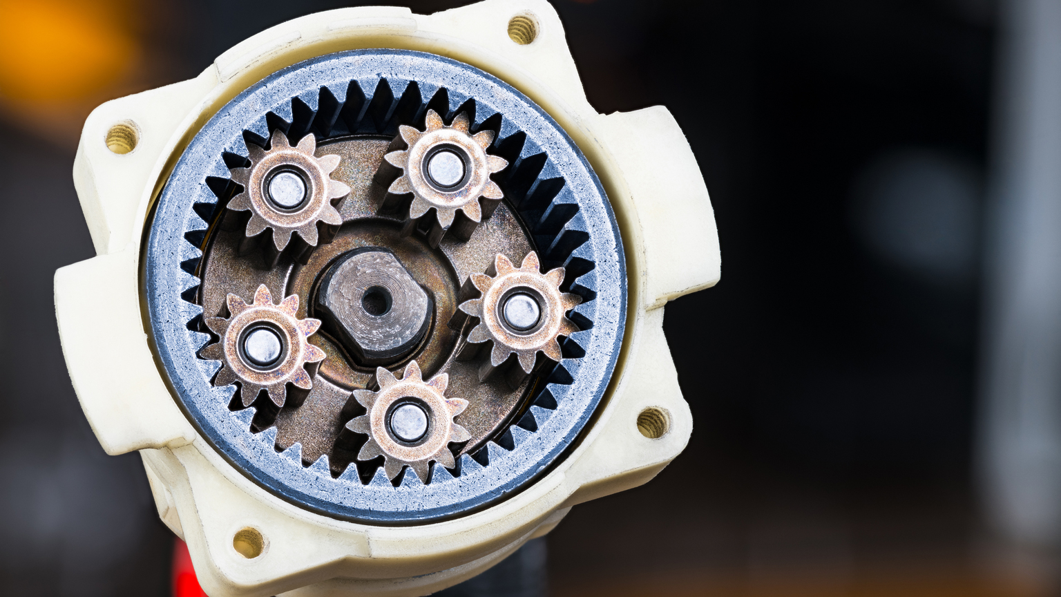

Planetary gears can supply high levels of torque and high-speed reduction. They are also relatively compact compared to standard pinion-and-gear reducers, thanks to their inherent in-line shafting and cylindrical casing.

Basic planetary gearing consists of three sets of gears, each with different degrees of freedom. Planet gears rotate around axes that revolve around a sun gear which spins in place. A fixed ring gear holds the planet gears in orbit about the sun gear and meshes with both the ring and sun gears. The planet grouping’s concentricity with the sun and ring gears means torque is carried through in a straight line.
READ MORE: Planetary Gear Ratios
In a simple planetary setup, input power turns the sun gear at high speed. The planets, equally spaced around the central axis of rotation, mesh with the sun as well as the fixed ring gear, so they orbit as they roll. All the planets are mounted to a single rotating member, called a cage, arm or carrier. As the planet carrier turns, it delivers low-speed, high-torque output.

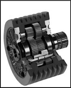

Compound planetary trains, unlike simple planetary gears, have at least two planet gears attached in line to the same shaft. They rotate and orbit at the same speed but mesh with different gears. Compounded planets can have different numbers of teeth, as can the gears they mesh with. This option expands the mechanical possibilities and allows more reduction per stage.
Compound planetary trains can also be easily configured so the planet-carrier shaft drives at high speed, while the suns shaft turns at a lower (reduced) speed. Compound gear trains can also mesh with and revolve around fixed and rotating external gears at the same time, eliminating the need for a ring gear.

Simple planetary gears can provide speed reductions as high as 10:1. Compound planetary gears are far more elaborate and can provide much greater reductions. There are also simple ways to reduce or increase speeds, such as connecting planetary stages in series. Then, the rotational output of the first stage becomes the input to the next, and the total reduction becomes the product of all the stages.
