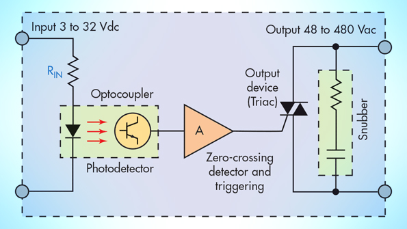

Solid-state relays (SSRs) control load currents through use of solid-state switches such as Triacs, SCRs (silicon-controlled rectifiers), or power transistors. The input signals that control switching typically enter the device through isolation mechanisms such as transformers, reed relays, or optoisolators. These isolation mechanisms prevent the high-power load current from inadvertently outing back to the relay input in case of a failure.
A typical solid-state relay incorporates inputs that are isolated from the power connections, a power switching section made up of solid-state switches such as Triacs, power MOSFETs, or IGBTs, and a snubber circuit to reduce EMI when the power circuit switches. It is also common for SSRs to switch on and off at the zero-crossing point of the ac wave as a means of reducing stress on the circuit elements.
Some SSRs incorporate snubber circuits or zero-crossing detectors to reduce spikes and transients generated when the SSR switches the load current through an inductive load where the sudden interruption of current flow leads to a sharp rise in voltage across the relay via Faraday's law. A voltage generated across the relay that is beyond what it is designed to tolerate may damage or destroy it. The snubber, usually a reverse-connected diode, provides a short-term alternative current path around the relay-switching device that lets the inductive element discharge.
