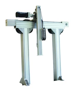

Five Heavy-Duty Gantry Alternatives
April 27, 2015
Save time and money with these five highly configurable products, all of which can be used in linear motion guided gantry configurations for factory floor automation in place of high cost multi-axis robots.

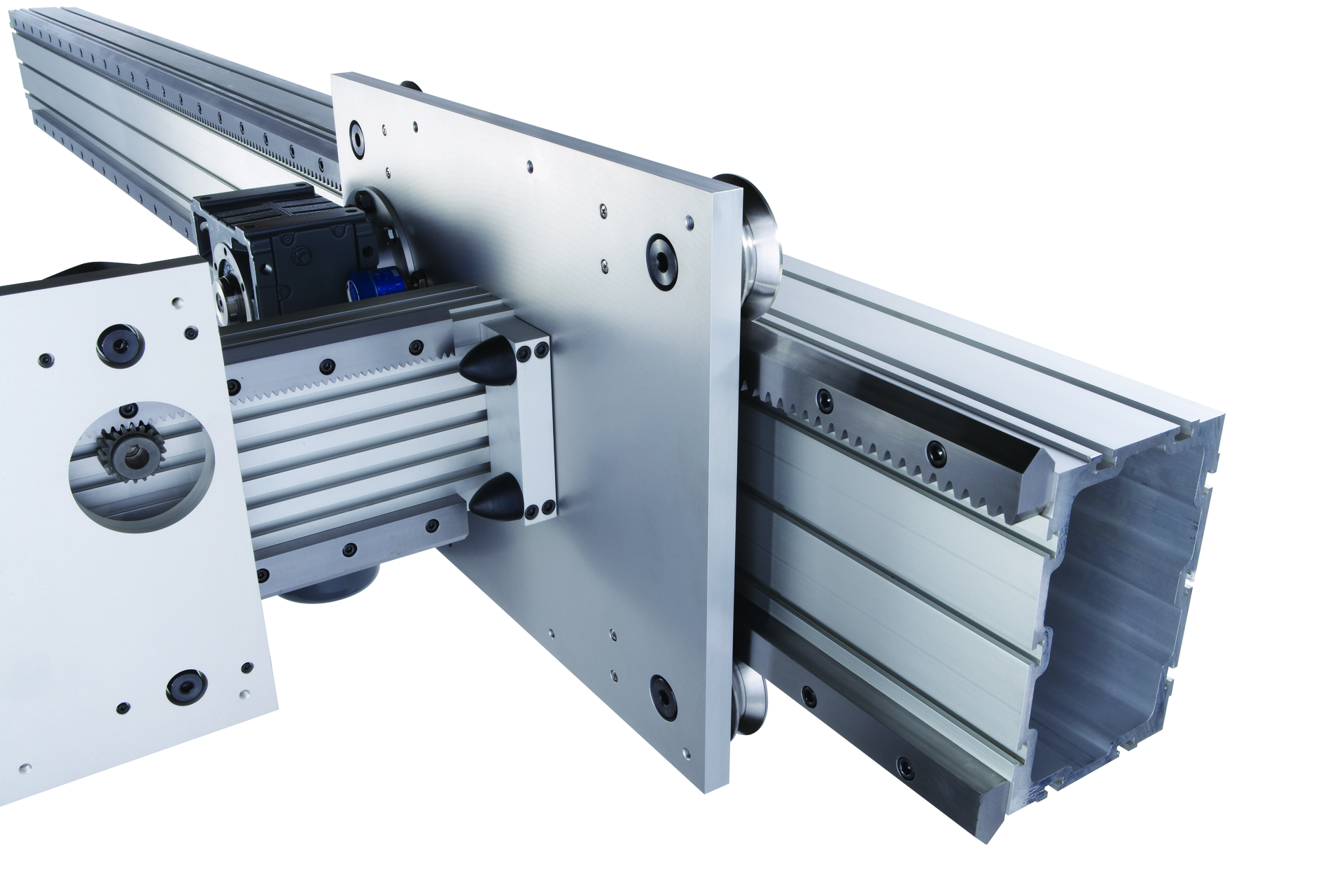

In some cases the main mounting plate for the X-axis can hold the linear guide bearings to the Z-axis and integrate all of the necessary pinion drive and automatic lubricator components. This greatly simplifies the design and reduces the overall moving mass (Fig. 4).
4. Shown here is a close-up view of a gantry carriage plate with bearings for two motion axes and an integrated gearbox.
