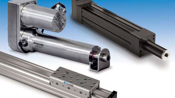

Screw-driven actuators can use rods or be rodless, like these actuators from Tolomatic.

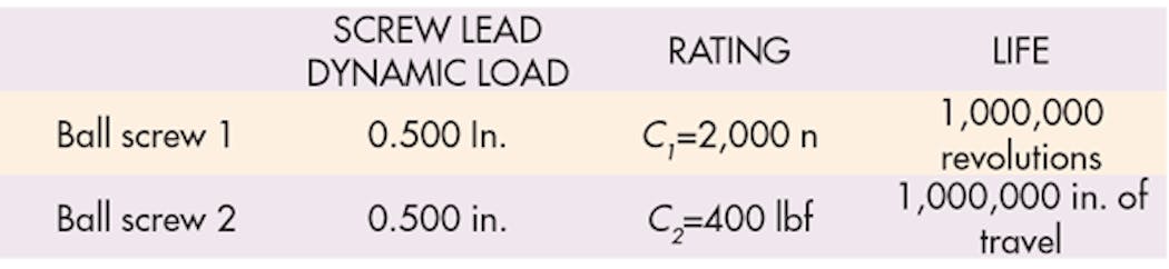

In one example of such conversion and comparison, a designer needs to compare the two ball screws shown in the table below.
First, convert the life of the second screw to revolutions (by dividing it by screw lead):
L10(2) = 1,000,000/0.500
L10(2)= 2,000,000 revolutions
Second, convert the dynamic load rating of the second screw to newtons:
C2 = 400 lbf x 4.45
C2= 1,780 N
Third, calculate the load rating of the second screw so life is reflected in 1,000,000
revolutions:
C2 = 1,780 N x (2,000,000/1,000,000)1/3
C2 = 2,243 N
The results show the load rating of the first screw is lower than that of the second one.
