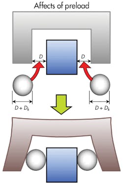

System stiffness
This is an area where mechanical factors often reduce the efficiency of the finest controls. The machine’s frame and base rigidity, thickness, material (for instance, aluminum versus steel), and frame construction (solid or tubular) can all have an impact on precision. Mechanical-drive-based factors such as preload, axis length, types of antifriction elements and bearing support, as well as the fasteners connecting the linear-motion system to the frame can all indirectly influence machine precision.
System stiffness is critical because any force or load applied to the motion components — downward, upward, or sideways — can cause deflection, an enemy of repeatability. Greater force produces more deflection. To combat this, designers often improve the overall rigidity or stiffness of the linear-guide block by introducing preload with oversized antifriction elements. The “Affects of Preload” graphic shows a typical preload, using oversized rolling elements (Dk) in the guide-rail gap (diameter D). Linear-guide manufacturers typically offer widely varying levels of preload to minimize deflection.
The drive can contribute to total system rigidity through the stiffness of its support bearings, ball-nut unit, and the ball screw itself. The biggest factor affecting the stiffness of the screw drive is its length: the longer the screw, the harder it is to compensate for deflection. Compensation techniques include extra preload or selecting a stiffer ball nut.
One way to correct for elastic deflection is to preload linear guides with oversized antifriction components.
