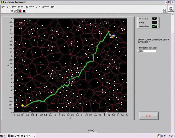

One path planning technique called a Voronoi algorithm notes the position of obstacles (shown as white dots on this screen shot) and computes the possible paths around them. When the robot is given a starting and ending point, the Voronoi algorithm computes the shortest path to the goal.

There are software drivers widely available for many of the sensors that find frequent use in mobile robots. Robotics has progressed to the point where path planning and obstacle-avoidance techniques are widely available as well. For example, in the case of LabVIEW software, standard software drivers can work with LIDAR sensors to acquire range data and pass it to advanced mapping and navigation algorithms. There are many path-planning algorithms in common use today. One such algorithm, called a Voronoi algorithm, notes the position of obstacles and computes the possible paths around them. When the robot is given a starting and ending point, the LabVIEW Voronoi VI computes the shortest path from the start to the goal.
