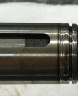

Damaged spindle close-up: Surfaces should be smooth, but here contamination has cut grooves into the spindle end.

Many factors contribute to failure, but leading causes are dirt, machining chips, and condensation that work their way into the spindle. For the latter:
• Common water-based coolants can cause rust to form inside the spindle.
• Spindle seals can also fail over time, leaving openings for other contaminants to enter.
• Thermal cycling can cause humidity to collect in spindles, particularly closed-unit types: Operation heats the machine, so that when the machine stops and cools, the resulting vacuum draws warm, humid air into spindle bearings.

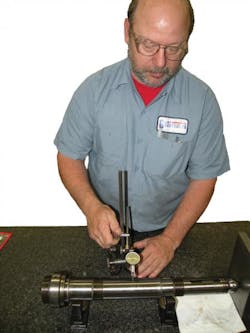

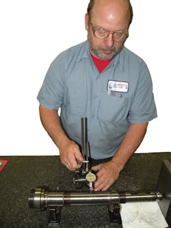

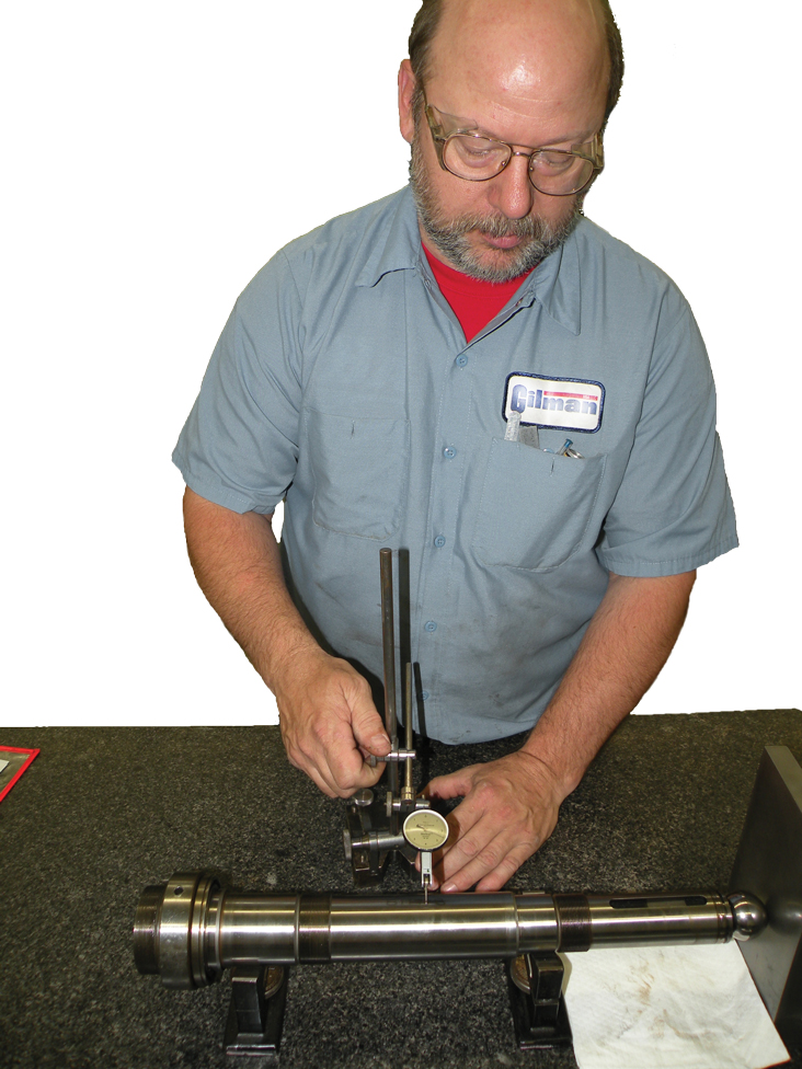

Some spindle servicing includes evaluation and repair of the entire spindle system, and aims to quickly get the machine operating again. A spindle to be serviced first undergoes inspection. Evaluation includes mapping of tolerances and runout.

Significant qualifications, equipment, and facilities are required for spindle servicing — in addition to expertise in how spindle systems are designed, how they operate in various applications, and how they work and interact with other equipment. At full spindle service facilities, class 10,000 cleanrooms with tightly controlled air quality (limiting the number of particles measuring 0.5 µm or greater for each cubic foot of air) also prevent bearing contamination. Providers with resources limited to simple lathes and grinders cannot offer such assurances.

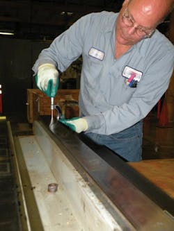

Slide considerations and repair
Spindles are often paired with slides to execute multi-axis application tasks — and these linear-motion devices can take a beating during normal operation. Cleanliness is the best way to keep slides operating well. Tip: During routine maintenance on the spindle system, lubricate the slides and brush dirt and debris off the slide covers as well. Such tasks take very little time.
The slides used in conjunction with spindles can slowly develop heavy layers of grime and rust. If a spindle is being serviced, it’s prudent and cost effective to concurrently service the system’s slides as well.
Once damaged, slides can degrade spindle performance or even cause their failure — often without being suspected. For example, parts manufactured out of tolerance could be caused by slides not properly holding spindle position.
Therefore, when a spindle system is getting serviced, slide servicing should also be considered. Most engineers aren’t aware that slides can be repaired, so they typically replace them when performance lags. However, slides are relatively simple in design, so their repair process is simple as well. Few service providers have the equipment necessary to make slide repairs, so this service isn’t widely available — but slides that are repaired provide years of service at about half the cost of new ones.
