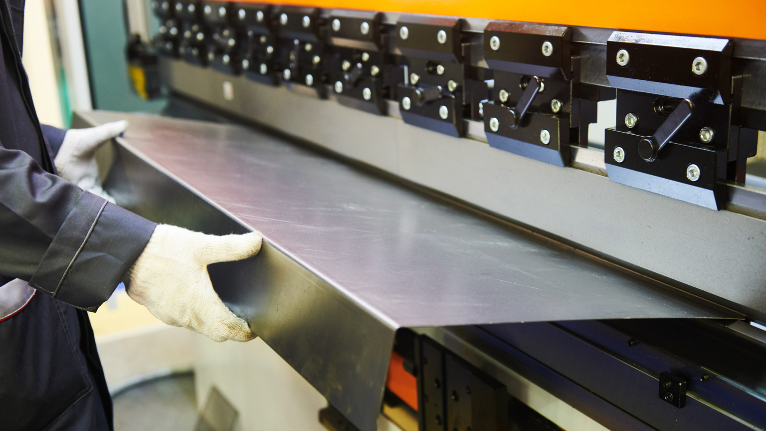

Engineers designing sheet metal parts and products are often unaware of the difficulties or impossible tasks their designs might present to shop floor personnel. Bends that are too tight, holes to close to the edges of parts and tolerances that can’t be met force engineers to redesign parts to accommodate manufacturing, an expensive proposition.
Unfortunately, research suggests that manufacturers spend 30% to 50% of their time fixing errors and almost 24% of those errors are related to manufacturability. These preventable engineering errors are due to the wide gap between how sheet-metal parts are designed in CAD systems and how they are actually made on the shop floor.
READ MORE: A History of Design for Manufacturing and Assembly
Companies could sidestep these costs and inevitable delays if they adopted Design for Manufacturing and Assembly (DFMA) principles. They would force designers to consider important manufacturability factors while developing sheet metal designs. DFMA focuses on simplifying designs and reducing the parts counts. It suggests using standardizing parts so they can be reused over and over in different applications. DFMA also provides insights on developing designs that are easier to manufacture.
Here are some of the DFMA tips and tactics engineers could apply to sheet metal designs.
Holes and Bends
In sheet metal designs, specifying hole sizes, locations and their alignment is critical. It is always best to specify hole diameters greater than the sheet’s thickness (T). Hole diameters less than the sheet result in higher punch loading and excessive burr. It also leads to slug-pulling when withdrawing the punch, which ultimately affects the life of both punch and metal sheet.
Spacing between holes also matters. It should be at least two times the sheet thickness (2T), if not more. Distance between holes maintains the strength of the metal and prevents holes from deforming during any bending or forming processes.
If holes must be near the edge, they should still be at least the distance equal to the sheet thickness (T) from the edge and preferably between 1.5T and 2T from the edge.
Distances between holes and bends should accommodate the bend radius (H) and be far enough from the bend. Usually, the preferred distance between holes and a bend is 1.5 times the sheet thickness plus the bend radius (1.5T + H). Supplying 3D models without considering these factors increases the chance of change orders from the factory floor.
