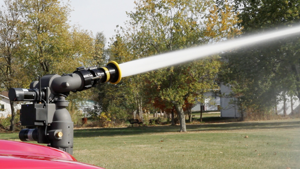

Water cannons, called monitors in the firefighting industry, allow firefighters direct water by aiming a spray nozzle mounted on a set of swivels to allow both horizontal and vertical motion. Elkhart Brass manufactures over 20 models of monitors such as their Sidewinder unit. Sidewinders can be remotely controlled from up to a quarter-mile away using RF communications.
Water cannons, called monitors in the firefighting industry, let firefighters direct water by aiming a spray nozzle mounted on a set of swivels that allow horizontal and vertical motion. Elkhart Brass manufactures over 20 models of monitors such as the Sidewinder unit pictured here. Sidewinders can be remotelly controlled from up to a quarter-mile away using RF communications. They are also used in fields ranging from the maritime industry for antipiracy to washdowns of mining and construction equipment, as well as trucks and airplanes. Water streams from a monitor can reach more than390 ft. The rate at which water is applied, not total volume of water, is what determines success. Firefighters calculate gallons-per-minute (gpms) of spray per estimated Btu of energy from the fire, not gallons per Btu. That is one reason why Elkhart Brass makes spray nozzles with precise flow rates. The unusual shape of the monitors serves to balance reaction force as high-velocity water shoots out of a monitor. It prevents the monitor from spinning on either axis when it is used.
