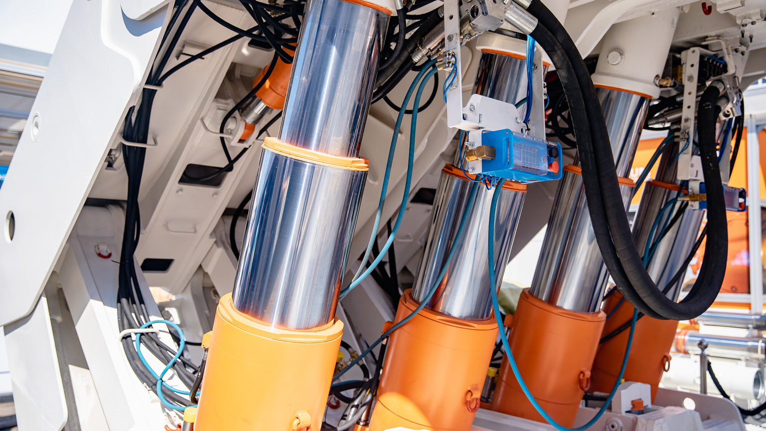

Evgeniy Parilov/Dreamstime
Pneumatic piston
