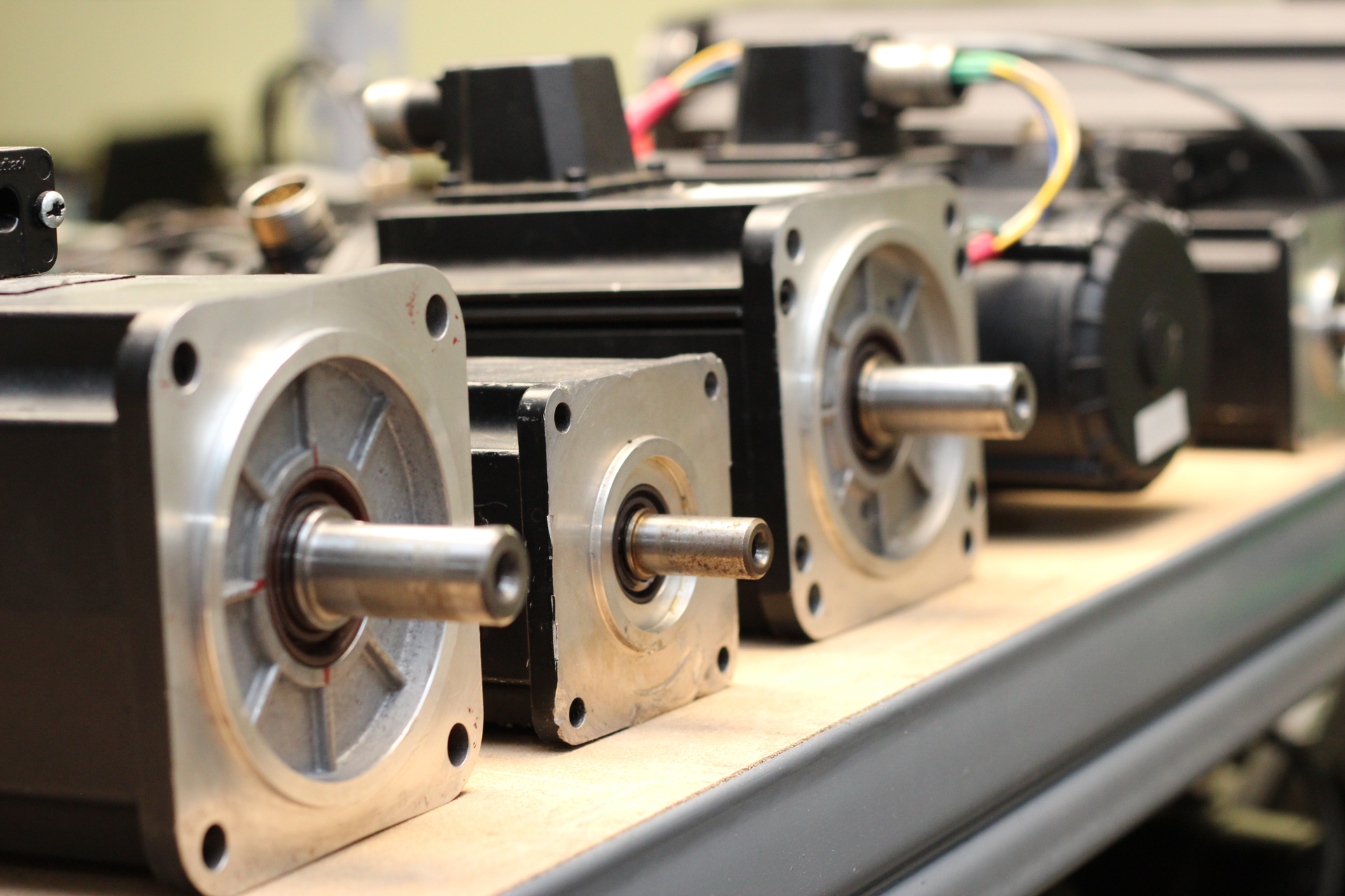

A shelf of servo motors representing various manufacturers, such as Allen Bradley, Rexroth, Siemens, Mitsubishi, Parker and Baldor. Providing power and precision, servo motors are the controlling force behind the equipment they run.
It’s Now Easier than Ever to Bring Servo Motor Repair In-house
