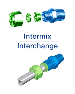

The Difference Between Intermix and Interchange
While subtle, the difference between intermixed and interchanged components is essential to understanding why either practice should be avoided.
  • Intermix occurs when tube fitting components, including the nuts, ferrules and bodies from two or more manufacturers, are mixed together and then assembled to make a completed fitting.
  • Interchange occurs when a tube fitting from one manufacturer that has been installed on a piece of tubing is then disassembled, and the tubing, nut and ferrules are then reassembled into a tube fitting body from another manufacturer.
