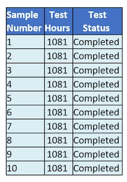

Once the testing plan was completed for the 10 gearmotors under stressed conditions, the next step was to execute the test plan. To perform the test, the 10 gearmotors and test instruments were set up on the test bench. This required a power supply, test fixtures, couplers, brakes, a wiring harness, a multimeter and a torque gauge. The required torque level was maintained using hysteresis brakes and torque limiters.
Functional testing on each motor was performed before the RDT test. No load performance was completed on all motors to ensure that the performance of each motor was within specification. During the RDT test, various performance parameters of the motors—including voltage, current, speed and temperature—were recorded daily.
In this case study, all 10 motors completed the required test time of 1,081 hours without failure. No abnormalities were observed in any motor; therefore, the required B10 life of 10,000 hours with 95% confidence level was validated through the test.
