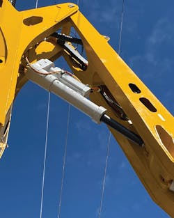

The Stinger is attached to the lattice work of a drill rig’s tower and consists, in part, of a boom and stick. At the end of the Stinger’s stick is a gripper clamp that grabs a 9-meter drill pipe staged in a holding area. The Stinger grabs and precisely swings the pipe section into position at the wellhead for a second gripper clamp to grasp and hold. While the second gripper holds the first pipe segment, the Stinger retrieves two additional segments and raises its boom and stick to connect each 9-meter segment to create a 27-meter pipe that it inserts into the wellhead. This is work that “roughnecks,” or oil rig workers, often perform. The Stinger eliminates all but one worker who supervises the automatic cycle of the machine from the safety of an operator chair away from the drill rig floor.
The weight of the piping and size of the Stinger’s boom and stick required engineers to conceptualize and develop three of the largest electromechanical linear actuators ever developed for this kind of application, each with a stroke length of 800 millimeters (31.5 inches). Two of the three actuators have a stall/peak force of 120/200kN, and the third has a stall/peak force actuator of 210/300kN.
The engineers who worked with Drillmec also designed the actuators for hazardous operations, including ATEX and IECEx certification, and pressurized each actuator to avoid contamination from dust and sand. Among the design challenges was sizing and integrating these three linear actuators, three rotary actuators, and six compact multi-axis servo drives into the design of the Stinger, while keeping the design within a compact footprint.
