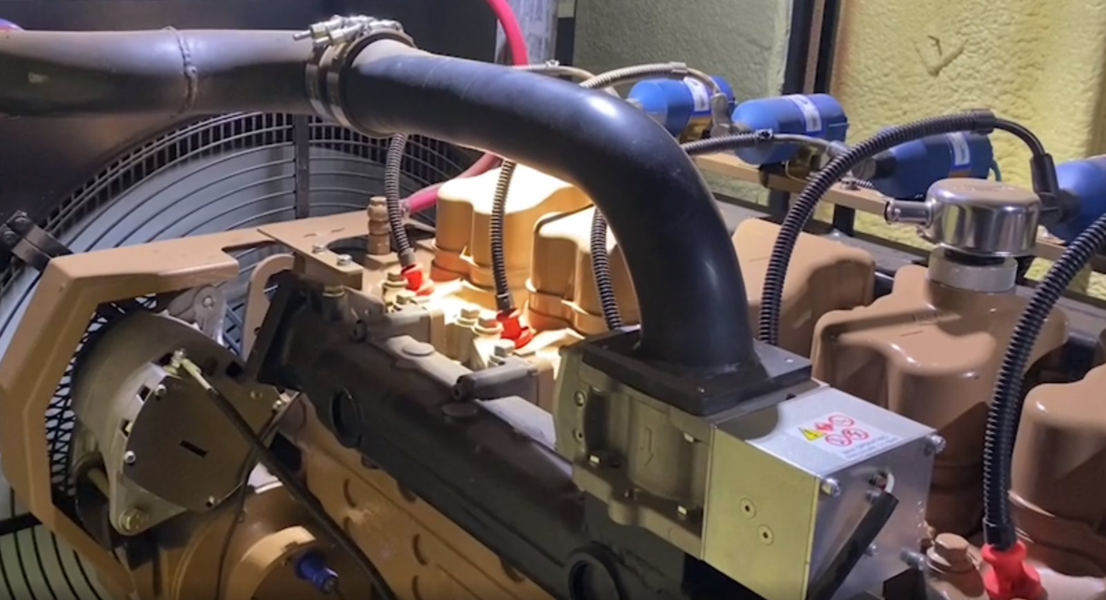

Courtesy GAC
GAC ATB65T2 on an SES A90 100 Kw Generator

The Solution: SES Arrow paired GAC’s ATB T2 Series Integrated Actuator/Throttle Body 45 mm and 65 mm with the GAC’s ESD5131 and ESD2241 speed control units. The actuator controls the flow of fuel into the engine similar to the gas pedal in a car. The speed control units, which are also called governors, control the throttle position of the engine, opening or closing it depending on the speed and stress on the engine. This maintains whatever speed is put into the speed controller, similar to cruise control in a car.
