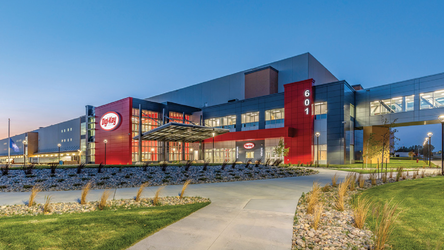

Scalability was prioritized in the design of a nearly fully automated pick, pack and ship conveyor system. The new Digi-Key Electronics facility is a study in high-service distribution of electronic components.

The new facility located at Digi-Key’s headquarters in Thief River Falls adds 2.2 million square feet to the existing premises. That’s a footprint of more than 22 football fields, or 1,045,600 square feet.
The PDCe building was designed by Minnesota-based Widseth, and McShane Construction served as general contractor on the project. Digi-Key has partnered with KNAPP, a warehouse logistics and automation specialist, to design and implement the internal automation and operational equipment.

Aside from the customized conveyor system, the facility itself showcases value-added engineering features. The construction incorporated 17,000 tons of steel, 1,860 pieces of precast concrete and a 328-ft steel bridge connects the expansion to the current headquarters.
The building features six backup diesel engines and pumps along with a water tank built for fire suppression. Sustainability features include the roof’s white membrane, which reflects the sun’s heat, and sensor-activated LED lights to minimize electricity usage. The facility also has its own storm sewer and run-off ponds to mitigate any flooding or storage concerns in the community.
